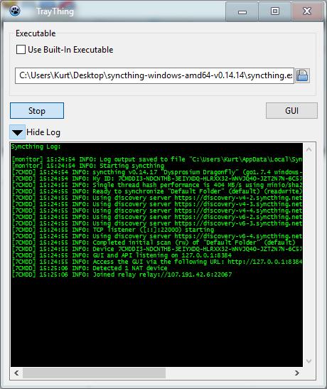

Hello all. I’ve been working on a tray tool, tentatively called TrayThing, for Syncthing. A very preliminary version is shown below.
I’ve run into a snag in the design of Syncthing that makes developing a controller for it more difficult. It seems like Syncthing forks into two processes when it starts off. Which is fine, but the forked process doesn’t terminate when its parent does, which is a problem. I will try to make it run under a job object so I can terminate the whole tree, but really, it should have a neat way of terminating everything.
The neat way of terminating things, is using the API or not using the monitor process and doing restarts yourself.
I’d really rather not have to implement http inside a simple tray wrapper. I’m not sure a wrapper for syncthing should have to know its GUI API any more than either Linux’s or Windows’ service managers know the APIs for what they control.
At the moment I’m able to successfully terminate things by starting the process suspended and attaching it to a job object before allowing it to run. I can then terminate it by terminating the job. This is the only thing that seemed to work - GenerateConsoleCtrlEvent() wasn’t much help.
Perhaps syncthing could be made to run with a switch that tells it not to use a monitor process at all. That’s really the job ob a service manager script or wrapper tool like mine anyway. The umbrella can itself take on the role of restarting in case of failure.
What is the status of the logo? I’d like to use the logo as the tray icon if possible.
Yep, -no-restart.
Yep, you can do that.
