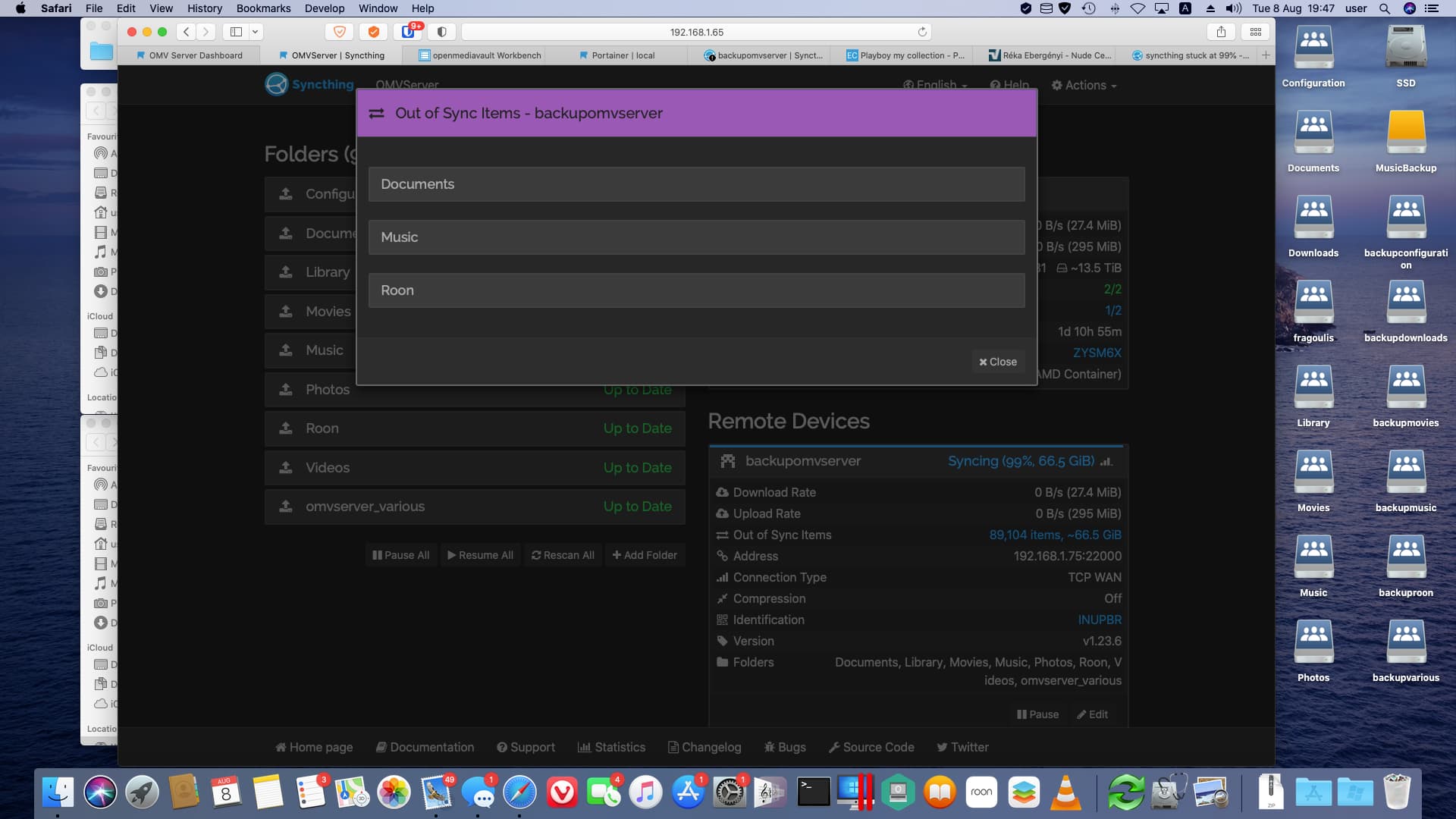

I haven’t checked your logs but when the sync was at 99% completion how many and which files were not in sync? You can click where it says how many files are out of sync and see the list of files.

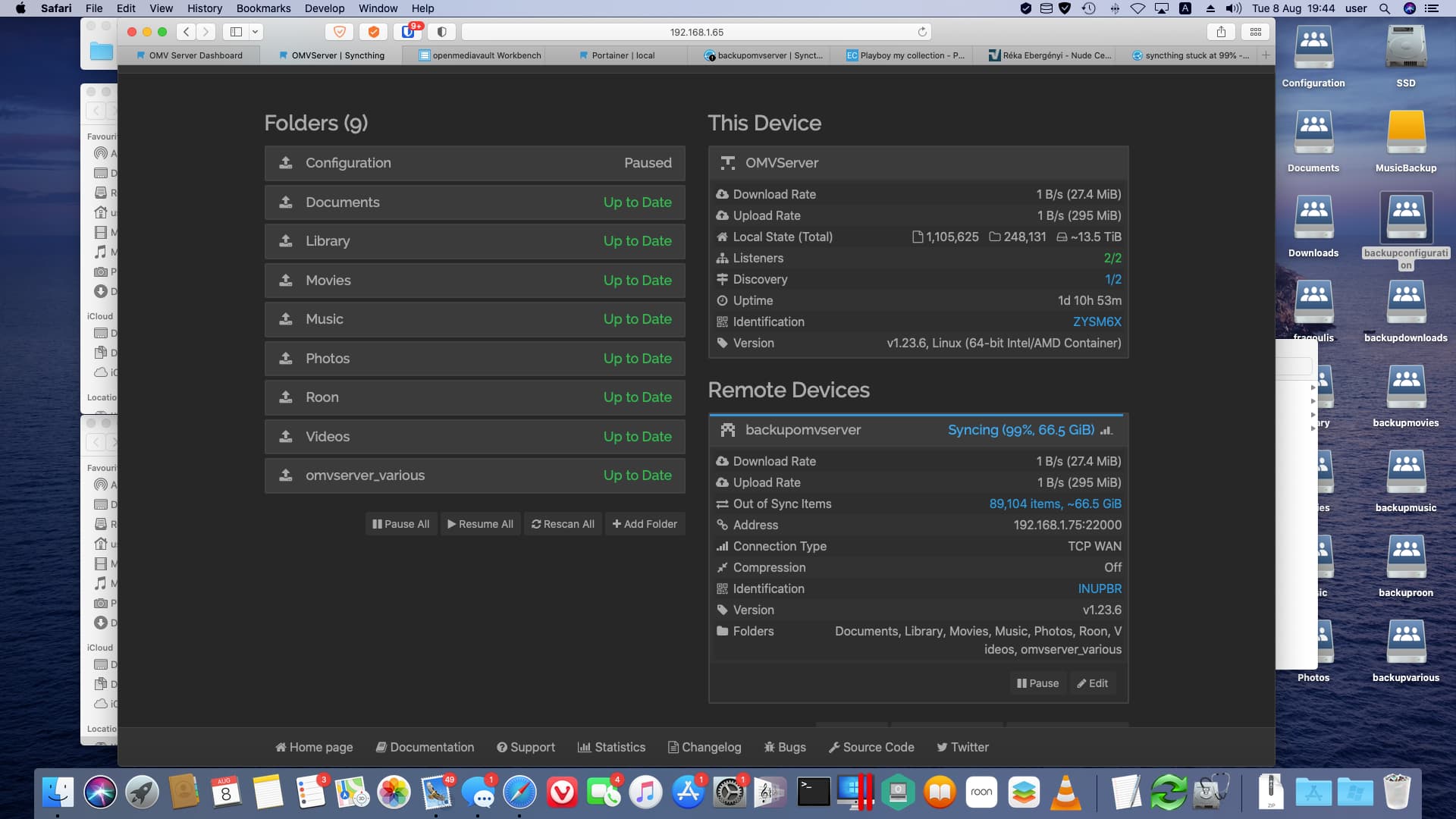

After the synchronization is completed, i rescanned all folders on both servers, however i still receive this 99% complete and syncthing still shows that 66.5GB of files are out of sync.
I made a test and created two test.txt files on server no1, in order to see if it will synchronize. Guess what, it synchronized almost immediately, which means that syncthing is working on both servers. Why then i receive this 99%?
Server1 has been set up to <> mode, server no2 has been set up in <> mode. I am thinking of uninstalling syncthing on server no2 and installing it again…

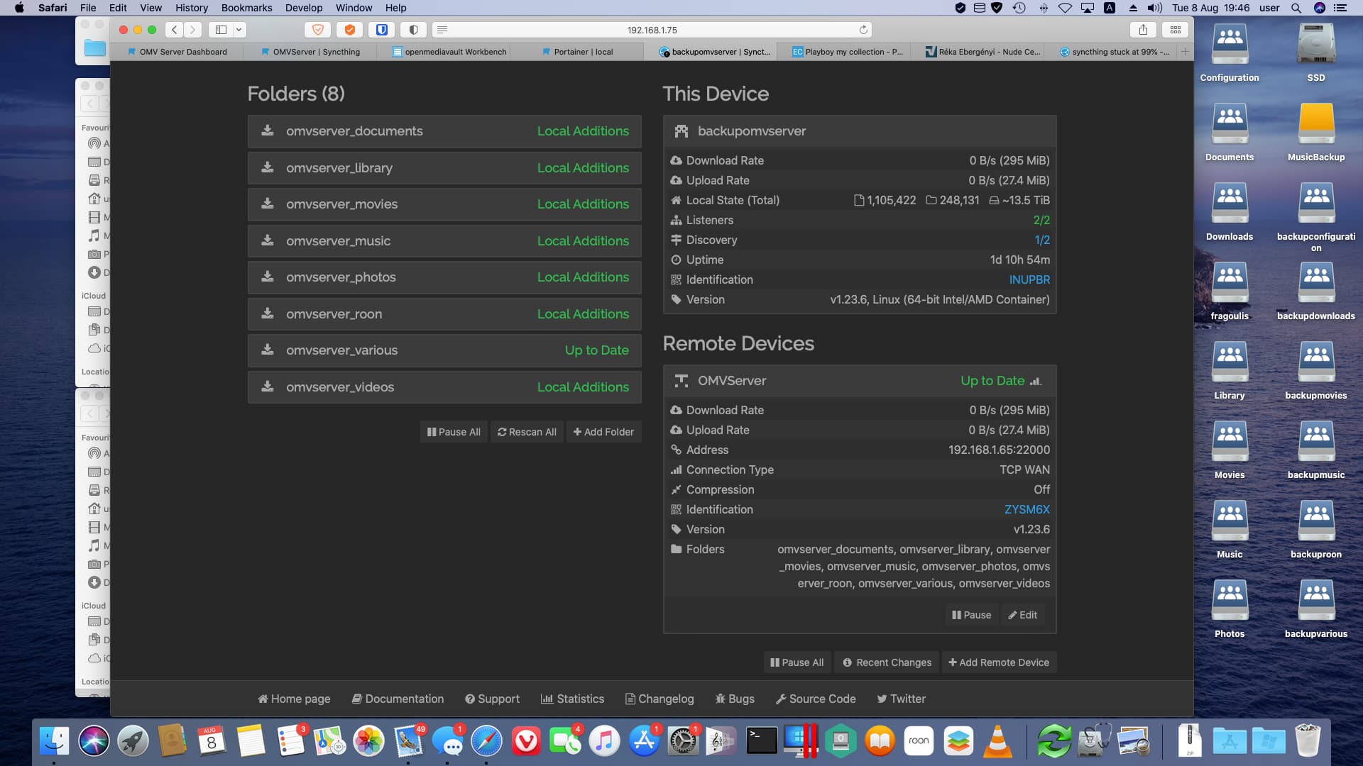

Can you post screenshots of the Syncthing Web GUI from both sides? Please make sure to unfold information about the folder and devices in question.
Find the requested screenshots. The local additions you see on serverno2 are the files created from freefilesync. All folders have been checked and they contain the same files on both servers
