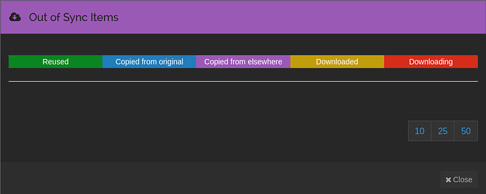

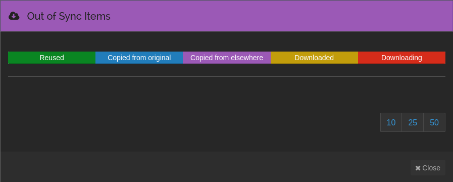

What item is out of sync?
When I click the “1 items”, it shows nothing:
