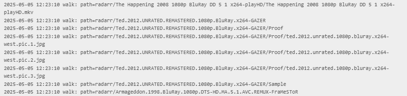

Thanks for the advice. I enabled fs and walkfs on both sides and rescanned. It looks like certain folders are being skipped over. I’ve attached screenshots below of the logs. I tested this with the movie Ted, which is not being synced properly from the seedbox to unraid. One thing that’s strange is I tested this recently with a new movie to see if this is a new permissions issue. The new movie synced and imported without problems. It looks like for the Remote Device on the seedbox side it is showing syncing at 0%, but the Remote Device on the unraid side is showing Up To Date (but with local additions on the shared folder).

I think I figured this out. For anyone who comes across this in the future it was the ignore rules I had set up. They should have only been ignoring .rar files from transfer, but I think it was ignoring any file with a .r in the name, which caused it to skip files.
Using this ignore rule seems to be working properly: (?i)*.r{[0-9][0-9],ar}
