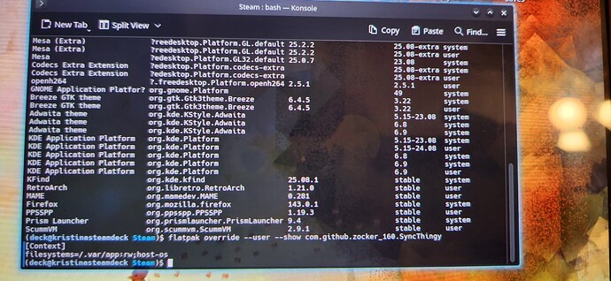

Here are my results. They match the inputs I entered into Flatseal. For reference, I was using the GTK wrapper, but now I am using syncthingy.
I don’t have a Steam Deck to compare your screenshot to, but SteamOS is based on Arch Linux, and I also use Flatpak, so the output from flatpak override doesn’t look right…
[Context]
filesystems=/.var/app:rw;host-os
Problems with the permissions above:
  • Your username looks like it’s deck, which normally means your home directory is /home/deck, but the filesystem parameter above specifies that SyncThingy is allowed to read/write to /.var/app.
    Although it’s possible that SteamOS isn’t sticking to the standard user home locations, it’s very unlikely (as a contribution to the Linux community, Valve is helping Arch Linux out with build infrastructure).
  • At the end of the parameter, there’s a filesystem subset attribute declared. host-os tells Flatpak that the app is restricted to using only system locations including /bin, /lib, /lib32, /lib64, /sbin plus limited parts of /etc, so /.var/app is off limits to SyncThingy.
To fix it, first reset the exisitng permissions…
flatpak override --user --reset com.github.zocker_160.SyncThingy

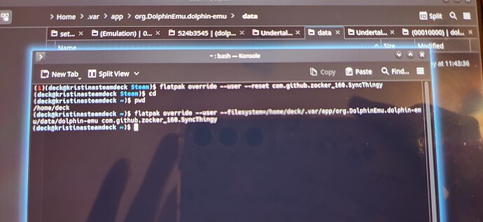

Next, verify your home by changing directories to it and displaying the current present working directory:
cd
pwd
(There’s more than one way to get the info, but I’ve chosen the one that’s the least cryptic looking.)
If your home directory is /home/deck, you can use the following commands as-is, otherwise adjust as needed.
Now set the override:
flatpak override --user --filesystem=/home/deck/.var/app com.github.zocker_160.SyncThingy
Note, the above permissions are pretty broad, allowing SyncThingy access to all Flatpaks under /home/deck/.var/app. Ideally, it should be more narrowly focused, especially if there are security-related apps (e.g. password manager, TOTP authenticator).
flatpak override can be used multiple times to append additional paths, each with its own restrictions, so you can gradually grant SyncThingy access to additional apps over time.
I’ve done this, and tried to be more specific to what flatpaks Syncthingy has access to. I’ve also checked to see if that solved the issue, and even when refreshing the game save locations I have still don’t match.

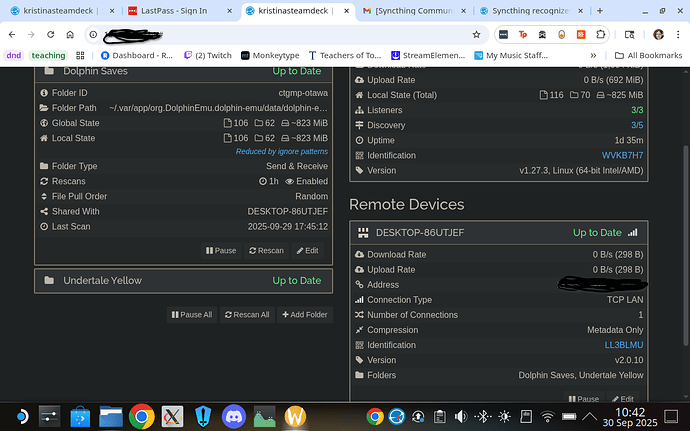

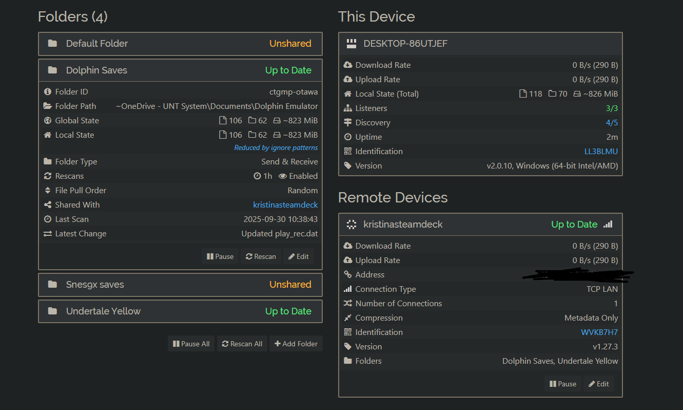

Screenshots of Syncthing’s UI from both the Steam Deck and PC would be very helpful, not of SyncThingy and/or other wrappers, but Syncthing’s native web UI that’s accessible on each device at http://localhost:8384/. The folder and device panels need to be open so that the details are visible.
Here is a screenshot of the steam deck
and here is a screenshot of the PC.
The folders still line up. Could onedrive be interfering? I could try and move my dolphin installation somewhere else on my PC.
The time span between the to screenshots is almost 15 hours, so it’s not exactly an apples-to-apples comparison, but otherwise it looks fine.
Yes, one issue is that cloud storage services with on-demand sync – files might be in the cloud with a placeholder on the PC, or both in the cloud and on the PC – generally do not play well with other sync programs. It’s not limited to OneDrive, so Dropbox, Box Sync, pCloud, Google Drive, etc. etc. are all affected.
When the Steam Deck copies a file to the PC and OneDrive replaces it with a placeholder, Syncthing on the PC will see it as a change and send it back to the Steam Deck.
However, it’s not yet clear that OneDrive is the problem because it would’ve resulted in mangled files on your Steam Deck.
The screenshots say you’ve got ignore patterns on both devices. Maybe the scope of the patterns is too broad, causing Syncthing to ignore all changes.
