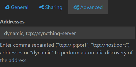

I host an OpenVPN server at home that I connect in to. I use a tunnel versus a tap, meaning it runs at layer 3 and thus does not forward broadcasts. As a result, I seem to be able to only get Syncthing to connect to my computers at home if I manually specify their addresses in Edit Device > Advanced > Addresses. I have a couple questions:
  1. I assume Syncthing uses broadcasts, and that’s why it won’t automatically connect to any of my computers over OpenVPN, is this correct?
  2. Assuming the above is correct, does that mean the only recourse I have is manually specifying the DNS name or address of each workstation and if so, is there a way to have the introducer automatically populate those versus having to manually configure each computer that will connect over OpenVPN?
Please see screenshot below of the current workaround I’m using:

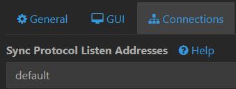

Interesting…if that’s true, this would probably be the solution I would go with, since I would then only need to configure the address to be the hostname on the relevant “servers”. Are these address settings set here:
So I would just remove “default” and put something like “tcp://hyper-v, default”? If this then populates via introducer, this would be my solution and what I’m ultimately looking for.
I’ll spin up a VM to try it out and report back, just in case anyone else is curious.
I was not referring to listen addresses. I was referring to the addresses you configure in Edit Device > Advanced > Addresses. Those are the ones you said you wanted it to propagate.
That’s what I’m currently utilizing now, but the introducer doesn’t seem to propagate those…unless what someone said earlier in this thread was true, where it is only propagated upon first adding a new Syncthing client but is never updated after that. Even if that were the case, I can’t find how to configure that on the introducer itself, only other clients that connect to the introducer by going to Edit Device > Advanced > Addresses.
That’s true. It only happens during the introduction process.
