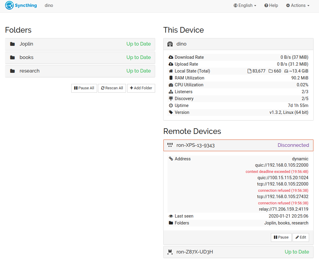

Here is a screen shot from another device, with Syncthing turned off on laptop (as explained in previous message, now that it is on same network, it works)
I am essentially interested what addresses each side sees when they are not connected and not on the same network. So far I’ve only seen one side of that.

From the server (dino) I cannot see the laptop, as shown in the image below:
To remind what I explained in my original messages: when all 3 devices are in the home network, they all see each other. Everything was working fine before the power blackout. This problem I am now having only appeared after the server unexpectedly shutdown.
That one screenshot was all that’s needed, the laptop would not even have had to be outside your network:
In the “This Device” section the “Discovery” status is 2/5. Given the global ip of the laptop isn’t listed, it’s most likely the global ones that aren’t running. Press on the 2/5 to get more info about that.

It switched to 3/5, so I think that means at least one global discovery is working, i.e. that shouldn’t be a problem anymore.
What’s weird though is the first failure: the discovery-v4.syncthing... shows an ipv6 address - I don’t get that. @AudriusButkevicius @calmh ?
