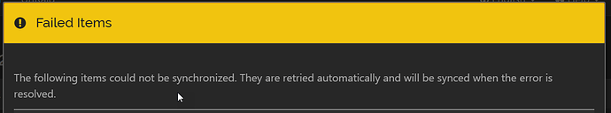

Hoping I can get some help here. Been looking on the internet for about 4 hours trying to solve this issue. Something changed on my Receiver Only side of SyncThing where its telling me its Out of Sync. Under Failed Items, I’m getting this message:
And on the specific files, an error stating:

Yes, these shouldn’t exist as I don’t want to resync these items as they will be duplicates.
Is there a way to ignore these as I’m showing 1873 items and I can no longer use SyncThing to pull anything new in.
