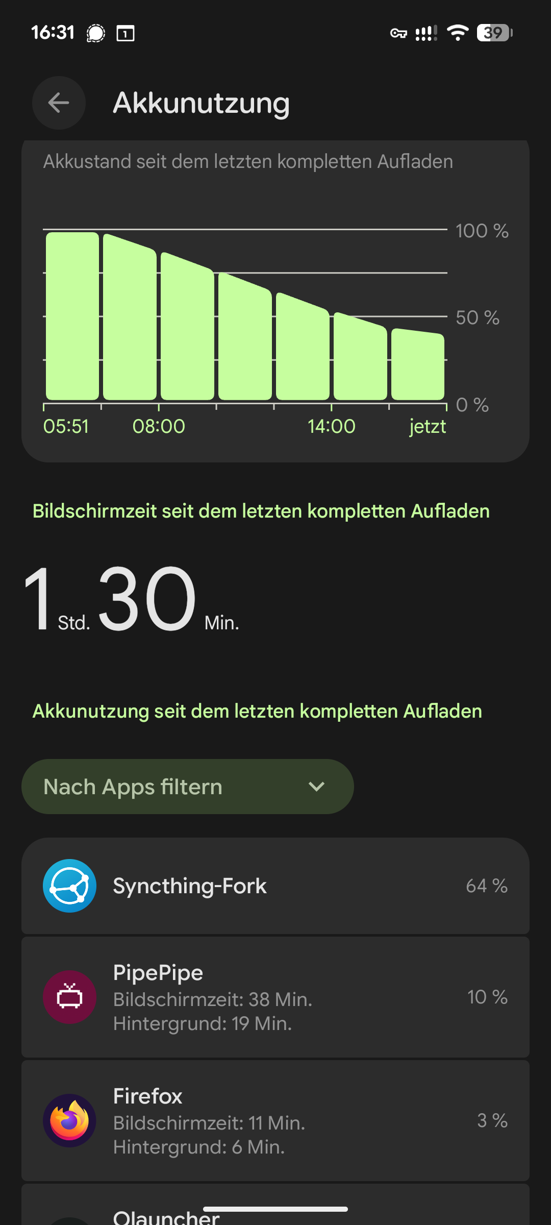

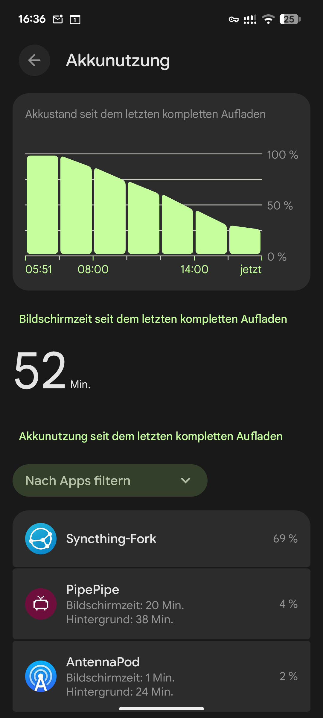

since I upgraded to syncthing v2 through Syncthing-Fork it uses loads of battery. It was getting marginally better with v2.0.10 over v2.0.9 but it still uses over 60 % (2.0.10 fix(syncthing): do not perform CPU benchmark on startup unless logging enabled by @pixelspark in #10398). With v1 syncthing was hardly even noticable compared to other services such as messenger apps e.g. Does someone else also see this behaviour?
I already tried to disable global discovery and relays, which didn’t really help and even with it being on it was working before. My Pixel 6 is on Android 16 and the battery is healthy enough. No changes there except the syncthing update. Also when I am not on wifi or deactivate syncthing my battery is fine again.

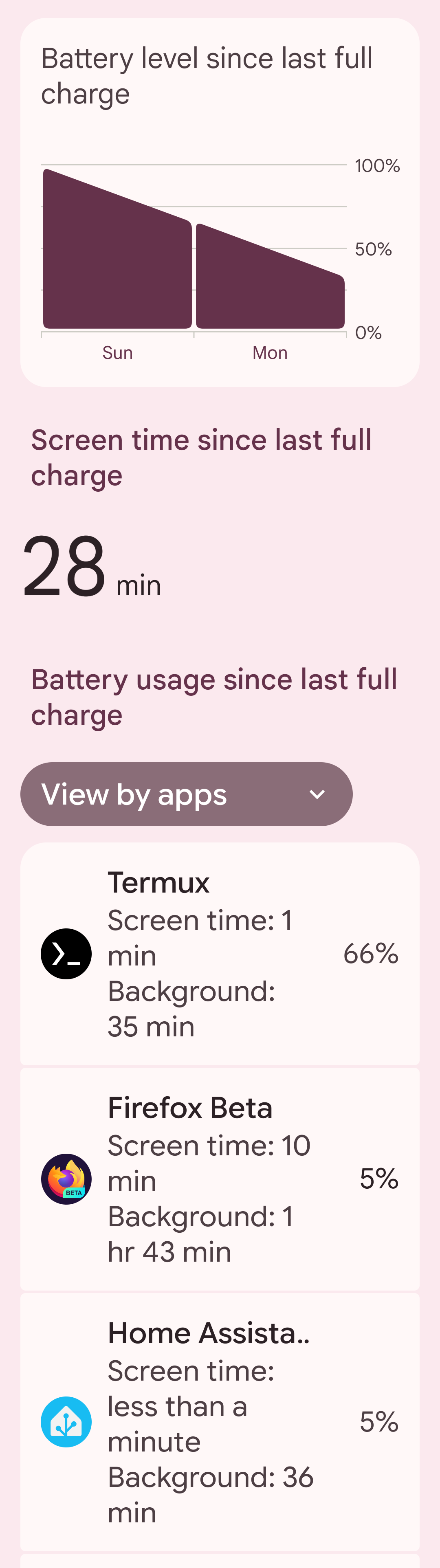

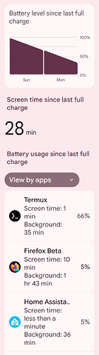

Since in my case, I had battery drain, without even configuring sync inside the Android App beyond auto-start and the foreground service notification, it’s easy to reproduce. I disabled the app, installed and started v2.0.10 in termux, and there I have exactly the same problem:
Meaning for me, the drain seems to be caused by syncthing itself, not the wrapper app.

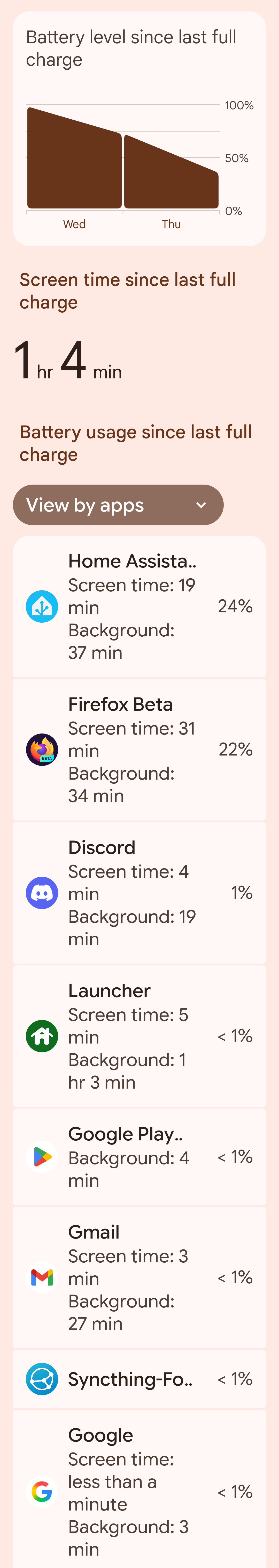

Another test using v1.30.0.4-fdroid. The battery consumption is so low, it barely shows up. I’ll try to backport syncthing native v2 to v1.30.0.4-fdroid to find out which code base is at fault here.
