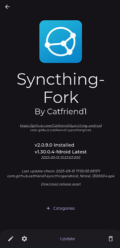

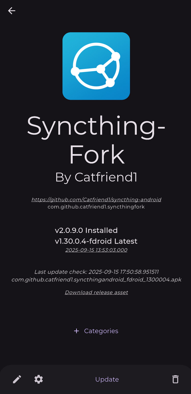

Syncthing-Fork v2.0.9.0 showing 1.30.0.4 as update in Obtanium
  • Android 13
  • Syncthing-Fork 2.0.9.0
Obtanium shows 1.0.30.4 as available update. Would expect to only see higher versions for the 2.x branch.
I would say this is likely something that you should report to Obtanium. It seems that they may only look at release dates and not actual version numbers.
Obtainium default to using the release date and the other option in that dropdown seem to be worse.
I set the “filter APKs for this regular expression” (or whatever the english translation/original is), to .*_release.* and Obtainium doesn’t show me the newest release (1.30.0.4 F-Droid) only as an update.
Works perfectly : I deleted the app from inside Obtainium, without uninstalling it then add it again with the GitHub URL and it was detected as installed with an update available (was with 2.0.9.0) and then updated.
