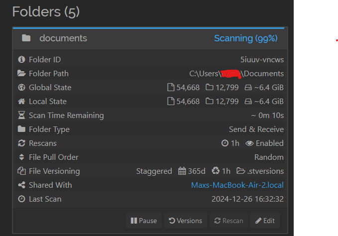

Screenshots
I’ve attached screenshots of the following for reference:
  1. Syncthing tray showing the missing remote device folders/files greyed out
  2. Folder settings on Device A and Device B.
  3. File comparison between the two devices using a file manager.
  4. The “Ignore Patterns” configuration for the folder.

So i tried the command to reset database. I also unshared the folders and deleted my .stfolder on both of the devices. I have not accepted my share on my other device yet I wanted to wait until it fully synced. You can see that the folder size on the synced folder is not equal to the folder size on my disk. Why is this happening? Seems like its not capturing all the files in the directory?

You can see that my state number is now closer to what is actually in my folder. However, my ignore pattern is still empty, so I’m not sure why they don’t match exactly.
Does this happen often? This is the whole point of Syncthing, and issues like this, which are difficult to diagnose, are quite frustrating. I spent a lot of time trying to resolve this bug. Syncing is the app’s main feature, and it’s essentially broken.

The numbers will never match exactly, because Syncthing won’t include its internal files and folders in the count. For example, those are the default folder marker (.stfolder) and the versions folder (.stversions) with their contents, and also all .tmp files which are still being downloaded.
Okay, thanks for the info. I know they issued a fix in that GitHub post, but will another one be released?
The problem wasn’t the small differences—it was that a large number of files that was missing over 1GB.
in the github post linked here there was a fix issued.
