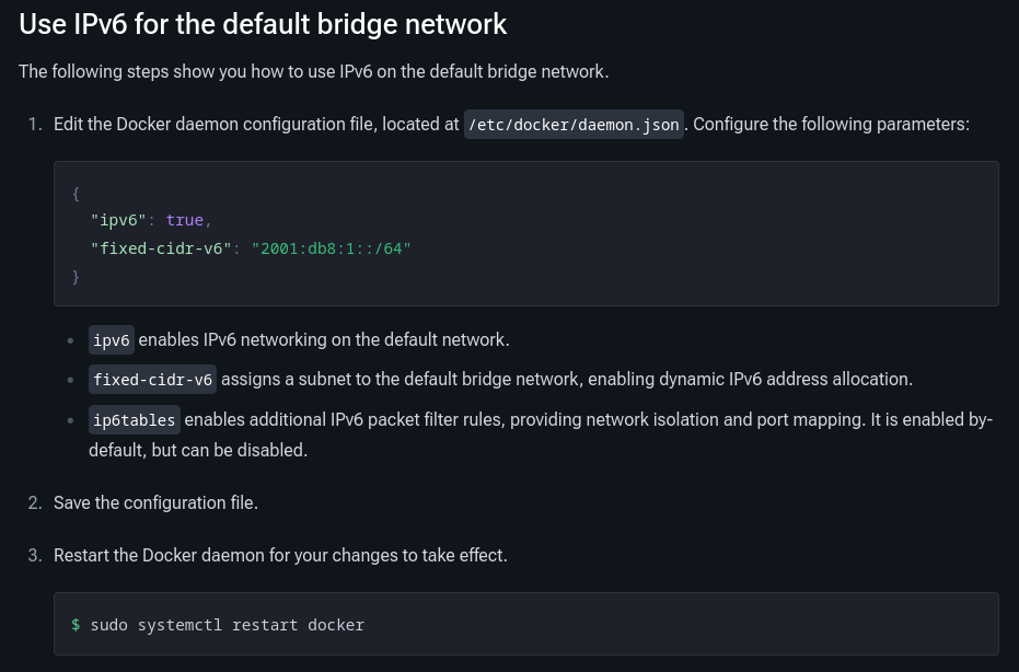

The Docker on the Pi is configured to support IPv6 as stated here Use IPv6 networking | Docker Docs . I can reach IPv6 servers when I try them from the Docker host. I’m at a loss. Can someone give me a hand with this? Thanks in advance. Cheers

I did this:
The Pi itself comes with IPv6 enabled on it’s eth0, but the bridge0 interface didn’t have IPv6 enabled. It thought that was the cause for Syncthing’s IPv6 issues and that’s why I made those changes. But it didn’t help. I still only get 4/5 on the Pi and it keeps outputting the same error message that I pasted in the first post.
