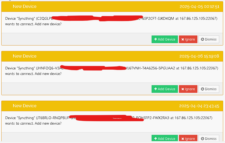

A desktop I have paired with my laptop has switched device ID’s twice now. I open the syncthing UI on my laptop and the desktop won’t connect and I get a message up top saying the desktop is requesting to connect. I check the ID on the desktop and sure enough it has switched to something new. This is the second time this has happened in the last week or two. I’m running Syncthing 1.29.4 on both devices with auto updates to the stable branch enabled. Any reason this may happen? Syncthing has been running fine on both devices with no issues for a few years now until the past 2 weeks.
