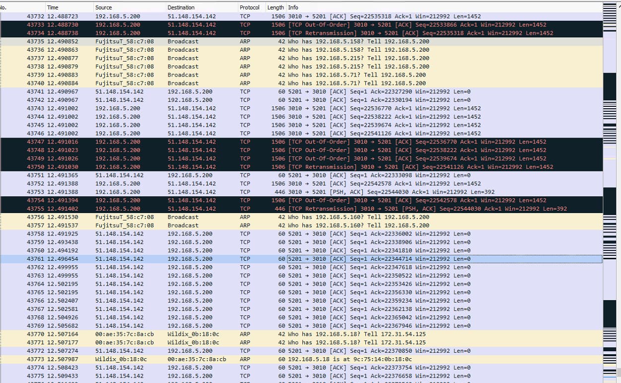

Ran a wireshark on one of the sites so I can reproduce the speed issue. I can upload the log if required. But it’s mostly
TCP Out of order / TCP retransmission / TCP Dup ACK
Which might explain excess packets and little actual data. There’s also a lot of UDP packets too, so is quic and tcp being used together to sync? eg, UDP for metadata, TCP for file data?
Ive just reran wireshark on a throttled sync, it’s mostly UDP packets and virtually no errors

Did you apply a filter to only capture traffic of the related clients? A mixture of QUIC/TCP might just be an indication that multiple clients are at work or you’re capturing other traffic.

I will look at iperf shortly, but the wireshark shows this when St is unlimited, 192.168.5.200 is the RO end, 51.148.154.142 is the SO end. Only St traffic would be flowing between these IPs
when I throttle back…

No filters applied
One is a TCP connection apparently suffering massive packet loss, the other is a QUIC connection. This seems to at least indicate it’s nothing related to QUIC – rather, that when there’s a lot of traffic the connection quality collapses and everyone suffers.
