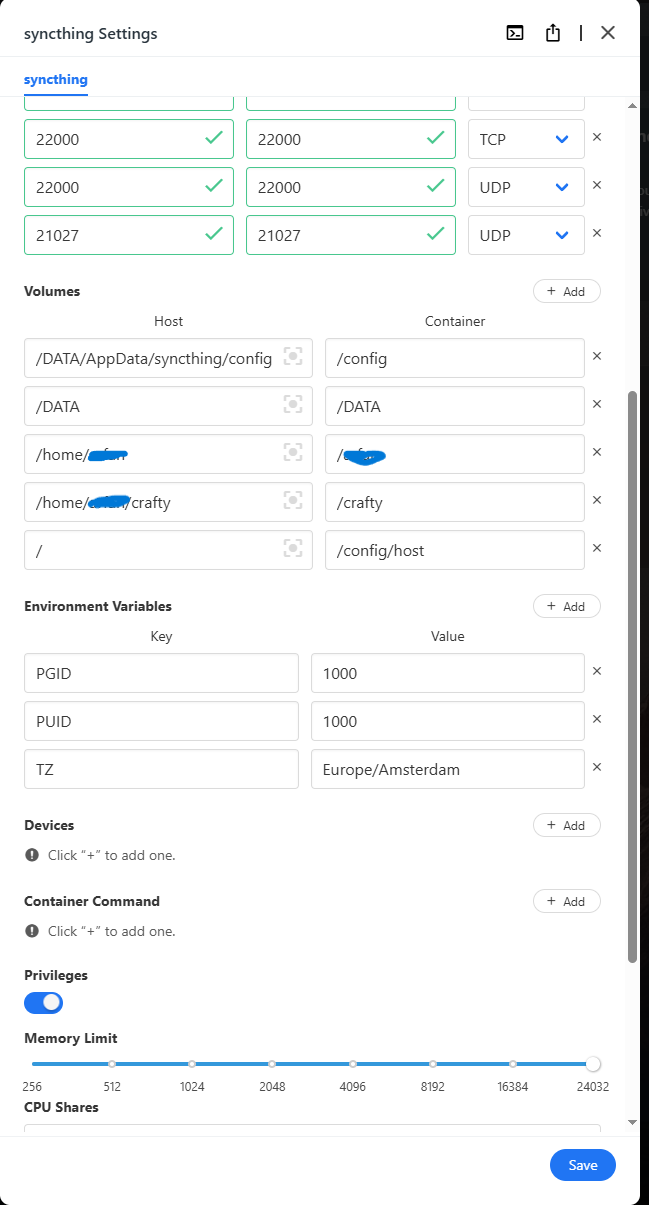

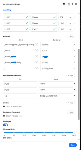

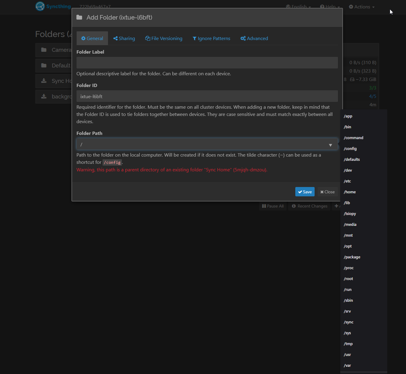

hello, i am running syncthing in docker container using casaos and i tried adding new volumes to the config but no matter what when i try to add the folder to sync it, it tries to create the folder instead of using it as if it does not exist

sidenote: why are you mounting your whole system root to /config/host in the container? this seems not that secure.
the interactive terminal is able to see those mounts and everytime i change something the container gets recreated.

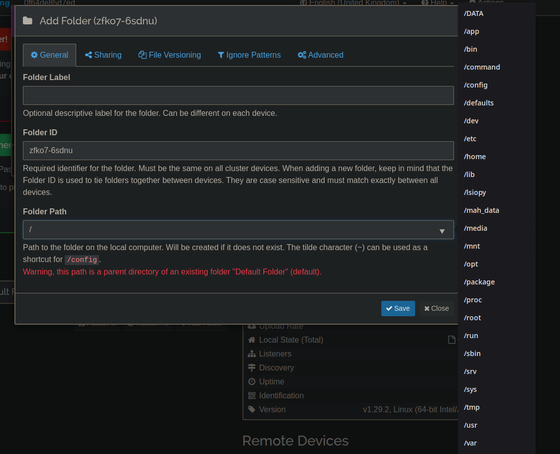

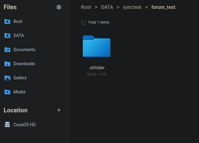

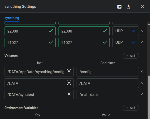

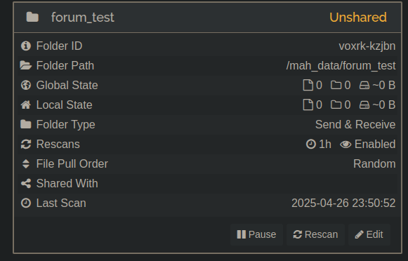

I tried to replicate what you have on the public casaos demo. where this “just” worked.
Did you create for example /crafty in a special way ?
that folder sits in my users home directory and has 777 as permisions as it is being used by another container but even if i add the root directory or any other regular folder it still does not work.
I have no idea how CasaOS works, but your used volumes look a bit suspicious:)
You map /DATA to some folder in your container, but also /DATA/some/child/folder to some folder in your container. But that child folder already exists in the container under /DATA/...?
Same with /home/_user_ and /home/_user_/child
And as cherry on top you map the root dir / of your Host machine to some folder in the container? That feels like a misconfiguration.
Clean up your volumes to only the ones you actually need. It’s prob all conflicting currently.
