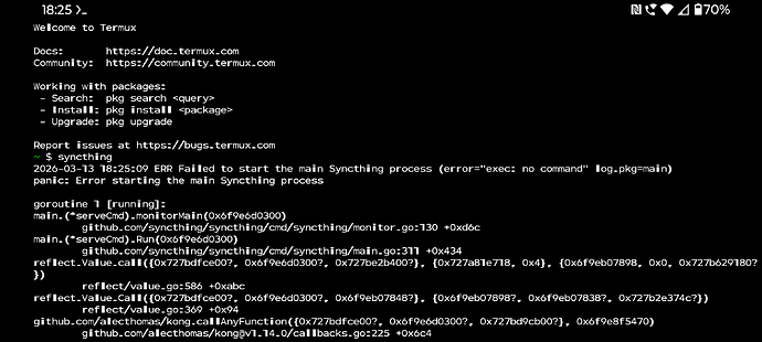

Earlier versions of Syncthing worked as expected in Termux, upgrading to 2.0.15 failed with errors indicating goruntime errors. (Changelog for 2.0.15 includes build with Go 1.26; use Go 1.25 features by @calmh in #10570. Could this be related? I have not been able to revert the Termux version to 2.0.14, any advice would helpful. This has also been reported on the Termux bug tracker. Termux version is googleplay.2026.02.11

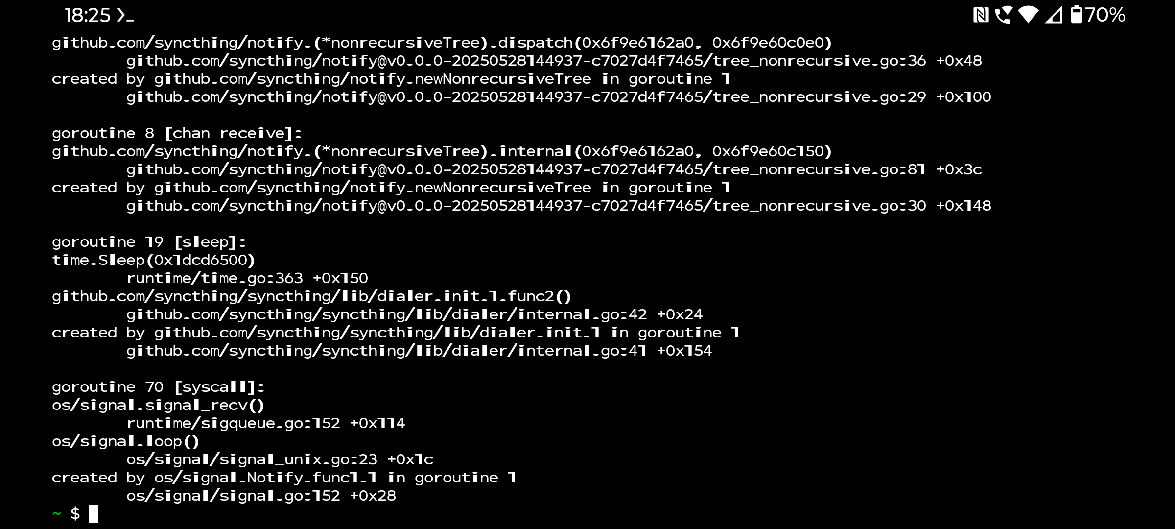

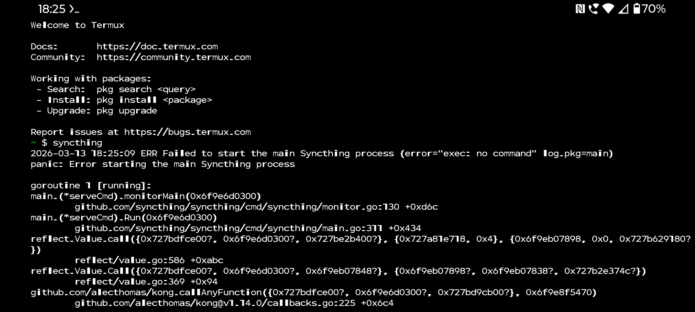

I’m not trying to keep the error ‘secret’, I simply don’t know how to capture the output/log from Termux. I’ll investigate further. Screenshots might suffice. Any advice?

I’m going to paste the error from the screenshot above because I ran into this issue today and missed this thread at first due to search not finding it when I searched for the error.
2026-03-23 12:04:41 ERR Failed to start the main Syncthing process (error="exec: no command" log.pkg=main)
panic: Error starting the main Syncthing process
goroutine 1 [running]:
main.(*serveCmd).monitorMain(0x1dceb7c6c300)
        github.com/syncthing/syncthing/cmd/syncthing/monitor.go:130 +0xd6c

goroutine 7 [chan receive]:
github.com/syncthing/notify.(*nonrecursiveTree).dispatch(0x1dceb7be62a0, 0x1dceb7bdc0e0)
        github.com/syncthing/notify@v0.0.0-20250528144937-c7027d4f7465/tree_nonrecursive.go:36 +0x48
created by github.com/syncthing/notify.newNonrecursiveTree in goroutine 1
        github.com/syncthing/notify@v0.0.0-20250528144937-c7027d4f7465/tree_nonrecursive.go:29 +0x100
goroutine 8 [chan receive]:
github.com/syncthing/notify.(*nonrecursiveTree).internal(0x1dceb7be62a0, 0x1dceb7bdc150)
        github.com/syncthing/notify@v0.0.0-20250528144937-c7027d4f7465/tree_nonrecursive.go:81 +0x3c
        github.com/syncthing/notify@v0.0.0-20250528144937-c7027d4f7465/tree_nonrecursive.go:30 +0x148
goroutine 11 [sleep]:
time.Sleep(0x1dcd6500)
        runtime/time.go:363 +0x150
github.com/syncthing/syncthing/lib/dialer.init.1.func2()
        github.com/syncthing/syncthing/lib/dialer/internal.go:42 +0x24
created by github.com/syncthing/syncthing/lib/dialer.init.1 in goroutine 1
        github.com/syncthing/syncthing/lib/dialer/internal.go:41 +0x154
goroutine 82 [syscall]:
os/signal.signal_recv()
        runtime/sigqueue.go:152 +0x114
os/signal.loop()
        os/signal/signal_unix.go:23 +0x1c
created by os/signal.Notify.func1.1 in goroutine 1
        os/signal/signal.go:152 +0x28
