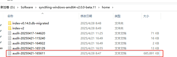

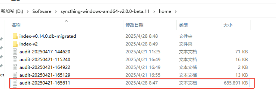

You can for the normal log files (see https://docs.syncthing.net/users/syncthing.html#cmdoption-logfile and the following log-related flags), but not the audit file.
