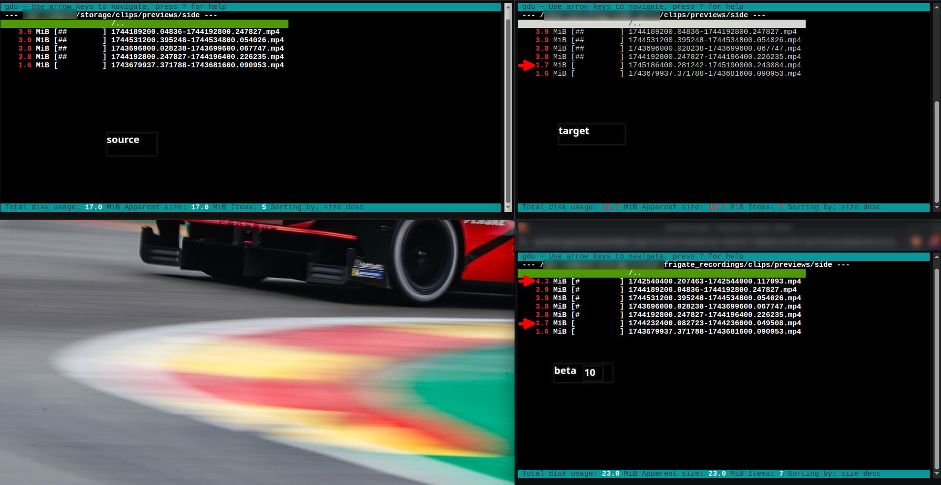

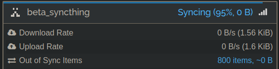

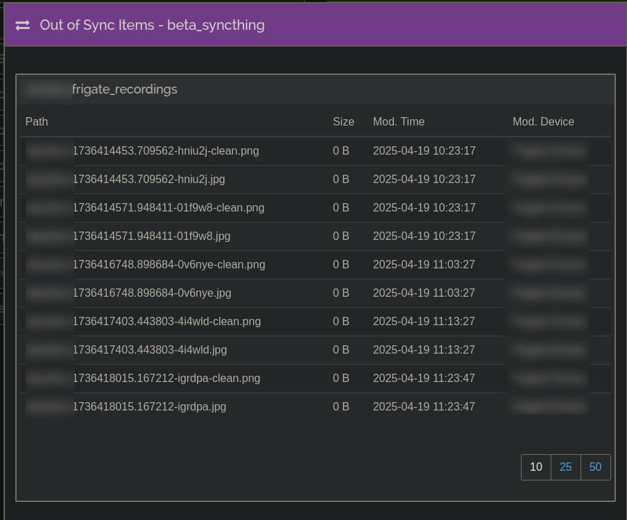

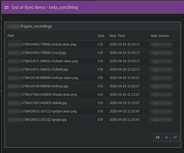

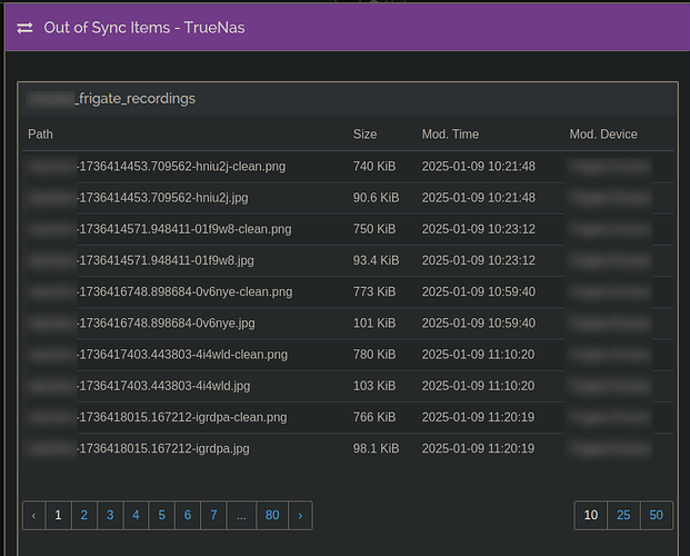

Just checked and it seems that all the files in the list are files that by now have been deleted. (expected behaviour off frigate (frigate is an NVR where I have auto-cleanup enabled) although the list shown in my previous post has grown in size (file-count and total size)
While checking though I noticed that the beta instance has more files that the source and the same for another normal instance.
folder settings
  • source (send only)
  • target (receive only)
  • beta (receive only) “Ignore delete” is disabled on all these folders
I can’t disable the nvr for security reasons so there will still be changes in files. But I’m not touching anything Syncthing related in case you want me to try something specific.
screenshot for clarity.

Yeah, bug from earlier beta, sorry. Reset database. :confused: or reset delta indexes everywhere.
No worries. That is why its called a beta.
I can confirm that resetting the database (only for that folder was enough) got everything back in sync.

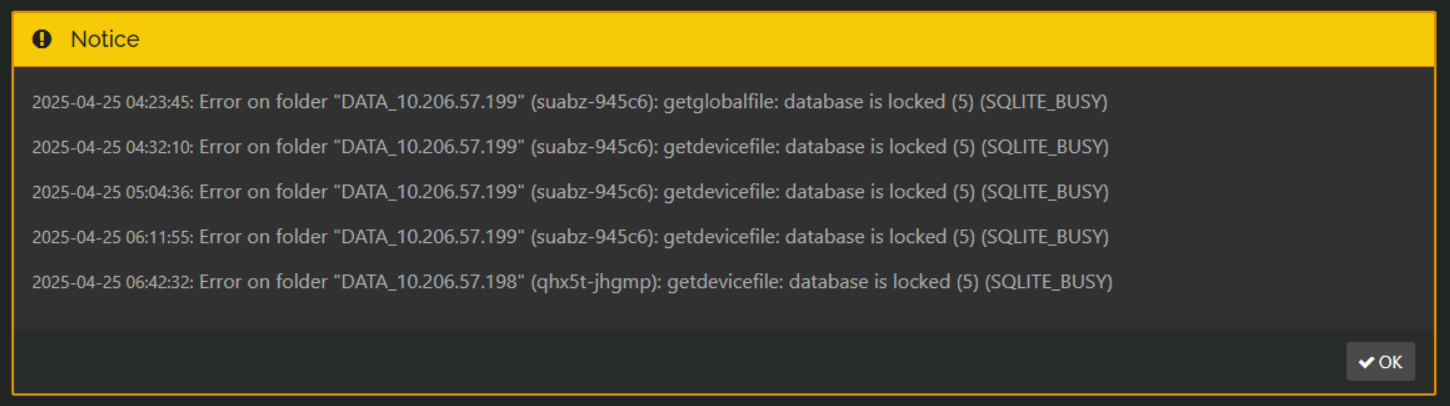

But you know, the performance of SQLite is not very good and often show busy errors, I’m wondering that do you have plan of use PGSql or MySQL replace SQLite in future?
Probably not, but it’s not impossible. Can you show examples of the busy errors you’re getting? It should not happen afaik.
As you can see above, I encounter this error very often.
Anything in particular happening while that goes on? Any more log entries that are not warnings? What operating system? Can you take a support bundle?
I add 4 folders to monitor 4 different servers’ source data folder in destination server. So, maybe there are many files are sync at the same time. There is no any other logs except this. Our OS is Windows 10.
