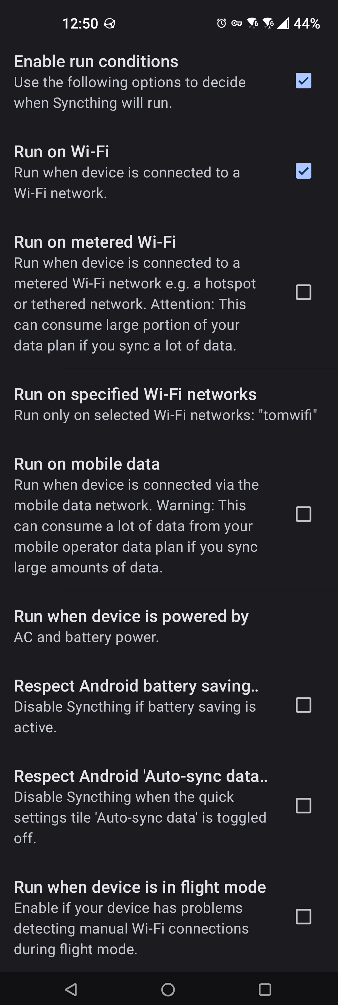

Since I changed settings to run only on my specified Wi-Fi occasionally get the notification that “Syncthing is disabled. Do you want to change the run conditions? Reasons: Current Wi-Fi SSID is not whitelisted”
Is there some setting that I have to change?
here is a screenshot of the Run Conditions…
Please make sure that Location Services are enabled in the Android settings and also that the Syncthing app is allowed to access location all the time. This is required in order for the app to know that the phone is currently connected to Wi-Fi.
Thanks. I got the notification while Location is enabled on my phone.
Is there an actual whitelist setting that I can add my Wi-fi to?
Is it allowed to access location “all the time” or only “while the app is in use”?
I had it set to “only while the app is in use”. Should it be set to “Allow all the time”?
Thanks.
Yes, you definitely should! Otherwise, it will only work reliably when the app is open.
