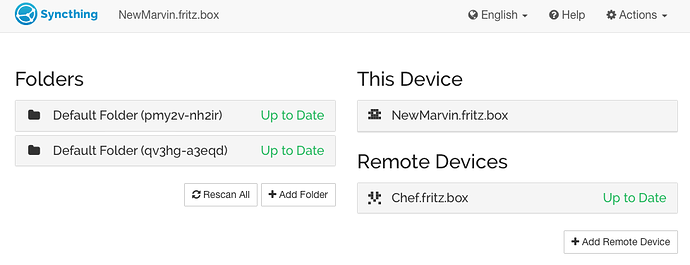

Now I have both machines connected, but have two folders in each of the machines. One default folder for each machine. That doesn’t seem correct. It is really the intended behavior to two connected folders for a single sync folder? Or did I misread the documentation and mess something up here?

When I now add each machine to the other I now have two sync folders pointing to the same folder.
I was expecting to have one folder on the left side that just gets synced. But as I read the interface I now have two sync folders syncing the same thing, namely the ~/Sync/ default folder.

Or asked the other way round. How do I make sure the Folder ID is the same if I am unable to edit it after it has been created and both ~/Sync folders that get created have different IDs?
