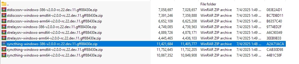

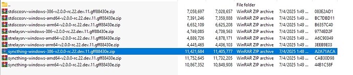

I ran the Syncthing from the highlighted zip file but got error.
D:\>syncthing debug database-file tnhbr-gxtuf TreeSizeFreeSetup.exe
syncthing: error: no such folder
D:\>syncthing debug database-counts tnhbr-gxtuf
You need to unpack the syncthing-amd64 zip file and run the Syncthing from there.

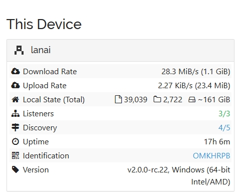

Just to confirm, your regular setup is 2.0.0-rc.22?
