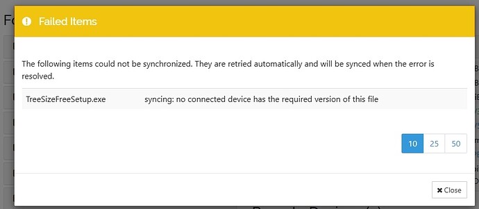

"syncing: no connected device has the required version of this file"
I deleted 2 files from a PC running Syncthing v2 RC22. Soon after, the folder is marked “out of sync” with 2 failed items. Both items have the message “syncing: no connected device has the required version of this file”. If I created 2 dummy files with the same names as the deleted ones, the folder is in sync again.

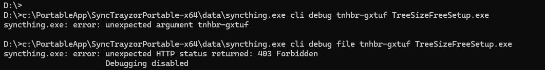

Output from syncthing cli debug $folderID $pathToFile (the path being that inide the folder)?
If I delete the dummy files, the folder will be out of sync.
How do I use the syncthing cli debug command? I tried D:>c:\PortableApp\SyncTrayzorPortable-x64\data\syncthing cli debug $tnhbr-gxtuf d:\win_apps\XnViewMP-win-x64.exe
and got
syncthing: error: unexpected argument $tnhbr-gxtuf
D:>c:\PortableApp\SyncTrayzorPortable-x64\data\syncthing.exe cli debug tnhbr-gxtuf XnViewMP-win-x64.exe
That should work better. Assuming the folder path you have configured for synchronization in Syncthing is d:\win_apps.
I also deleted 5 files from another folder and that folder also shows out of sync.

Sure, it’ll do that, because then the only version Syncthing knows about is the one you have. But you have 14 other devices, any of which apparently could announce a different or newer version of a file. On startup, until those have connected, “no connected device has the required version” is reasonable.

Ran into the same issue after the deletion of several files. Going back to V1.xx.
What is the reason I got the “…no connected device has the required version of this file” message, because some of the devices are not on the network? What is the proper way to handle this? Remove/add the folder?
Don’t know, but the output from the debugging command we asked for might be useful.
The output I posted a few days ago is not detailed enough? I’m trying to understand how this process works. If I delete a file on device-A, why would Syncthing on device-A look for the file on other devices after the deletion? Doesn’t device-A tell other devices to delete the file as part of the synching process?
The output you posted is not from the command we requested, and which you quoted. It’s from starting Syncthing without any parameters and just letting it run. The cli debug subcommand should be run from a different terminal while Syncthing is already running normally, because it asks it for some information about the file in question.
Yes. So something else is going on, most likely that those files are getting changed in some way that you don’t see.
Ran the debug subcommand in another terminal but was not successful.
Please try enabling Debugging in Actions → Advanced Configuration → GUI.
c:\PortableApp\SyncTrayzorPortable-x64\data\syncthing.exe cli debug file tnhbr-gxtuf TreeSizeFreeSetup.exe

    "size": 13832808,
    "type": "FILE_INFO_TYPE_FILE",
    "version": [
      "HZJYWFM:1751507473",
      "OMKHRPB:1751601122"
  "local": {
    "blocksHash": "7B4kLitFVZHp8e45zh+eTlscBai+/Q1tBH3lH8eO+Ng=",
    "deleted": false,
    "ignored": false,
    "inodeChange": "1969-12-31T16:00:00-08:00",
    "invalid": false,
    "localFlags": 0,
    "modified": "2025-06-22T20:16:10.2804841-07:00",
    "modifiedBy": "OMKHRPB",
    "mustRescan": false,
    "name": "TreeSizeFreeSetup.exe",
    "noPermissions": false,
    "numBlocks": 106,
    "permissions": "0755",
    "platform": {
      "Darwin": null,
      "FreeBSD": null,
      "Linux": null,
      "NetBSD": null,
      "Unix": null,
      "Windows": null
    "sequence": 497,
    "size": 13832808,
    "version": [
D:\>c:\PortableApp\SyncTrayzorPortable-x64\data\syncthing.exe cli debug file tnhbr-gxtuf TreeSizeFreeSetup.exe
  "availability": [
      "fromTemporary": false,
      "id": "J5WNYJ6-NTFZUN6-7RVSOTO-ULVOSEL-XRL7MTI-EWPLY3O-ZFHWIMC-QIG3DQB"
  "global": {
    "deleted": false,
    "ignored": false,
    "invalid": false,
    "localFlags": 0,
    "numBlocks": 106,
    "platform": {
      "Darwin": null,
      "FreeBSD": null,
      "Linux": null,
      "NetBSD": null,
      "Unix": null,
      "Windows": null
    "sequence": 497,
    "size": 13832808,
    "version": [
  "local": {
    "deleted": false,
    "ignored": false,
    "invalid": false,
    "localFlags": 0,
    "numBlocks": 106,
    "platform": {
      "Darwin": null,
      "FreeBSD": null,
      "Linux": null,
      "NetBSD": null,
      "Unix": null,
      "Windows": null
    "sequence": 497,
    "size": 13832808,
    "version": [
That looks like it’s in sync.
Another run of the debug command after the file is deleted.
  "availability": null,
  "global": {
    "deleted": false,
    "ignored": false,
    "invalid": false,
    "localFlags": 0,
    "modifiedBy": "HZJYWFM",
    "numBlocks": 106,
    "platform": {
      "Darwin": null,
      "FreeBSD": null,
      "Linux": null,
      "NetBSD": null,
      "Unix": null,
      "Windows": null
    "sequence": 234,
    "size": 13832808,
    "version": [
  "local": {
    "blocksHash": null,
    "deleted": true,
    "ignored": false,
    "invalid": false,
    "localFlags": 0,
    "modified": "2025-07-04T04:52:36.2804841-07:00",
    "numBlocks": 0,
    "platform": {
      "Darwin": null,
      "FreeBSD": null,
      "Linux": null,
      "NetBSD": null,
      "Unix": null,
      "Windows": null
    "sequence": 499,
    "size": 0,
    "version": [
      "OMKHRPB:1751629956"
Fascinating. That sure looks like a bug. Let me think on it.
