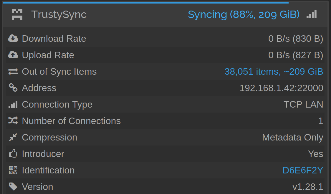

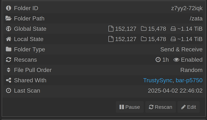

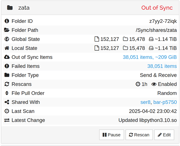

Now both devices show the folder with 152,127 files and 1.14 TB of data, however on recreating the folders my linux computer says “Up to Date” and that the TrueNAS remote device is 88% 209 GB out of sync. The TrueNAS server says its folder is “Out of sync” but shows the same number of files, but specifies 38.051 items out of sync.
Linux computer:
TrueNAS server:

The TrueNAS logs image didn’t seem to upload. Here it is:
This is repeated many, many times for many different files.
Again, any help appreciated. Thank you.
Okay, I solved it…
I had transferred files via a windows share on the TrueNAS server to the synced folder - this used the permissions for the windows share user on the TrueNAS and not the syncthing user. The group was correct, but I am not sure syncthing on TrueNAS always works with group permissions vs user, I think I ran into that problem in the past. Anyway, after:
chown -R syncthing:shares /new/directory/with/problem
chmod -R 750 /new/directoryo/with/problem
A new scan fixed the problem, all files synced!
