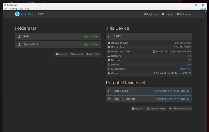

have set up several remote devices I am synching data to and it works great. But for some reason the sync status on the source PC is “stuck” at saying 53%, even though on the other end it is “up to date” and it’s actually updating the files.
I cannot find a way to reset this. It must have saved the status in some file.
Obviously I have tried restarting and the usual things.
On the source:
On the remote (Stu2-PC-Shared):
On the remote (Stu1-PC-SM):

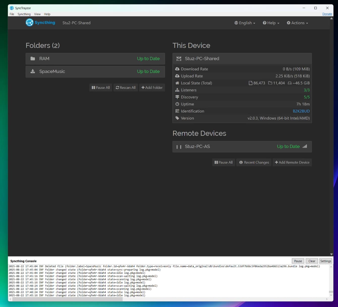

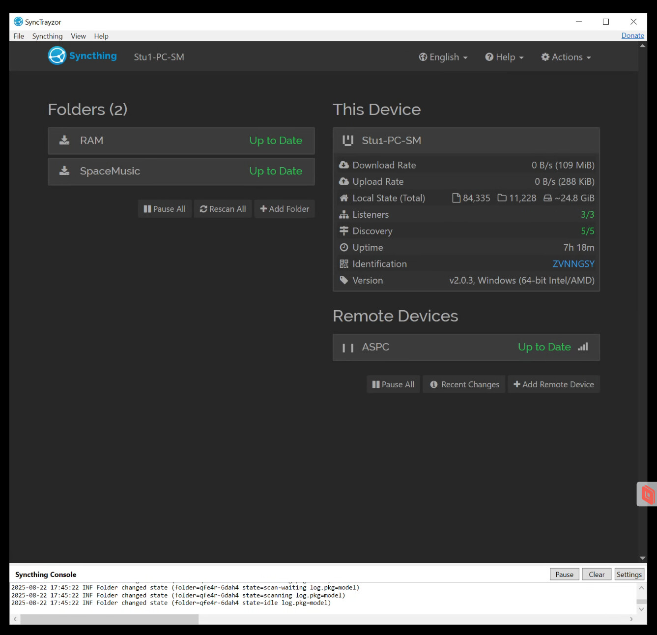

Here are screenshots from the 2 Target PCs. As you can see they are both up to date and the data is indeed all there.
I have set the “source” to send only and the 2 “receivers” to receive only, effectively doing a one-way sync.

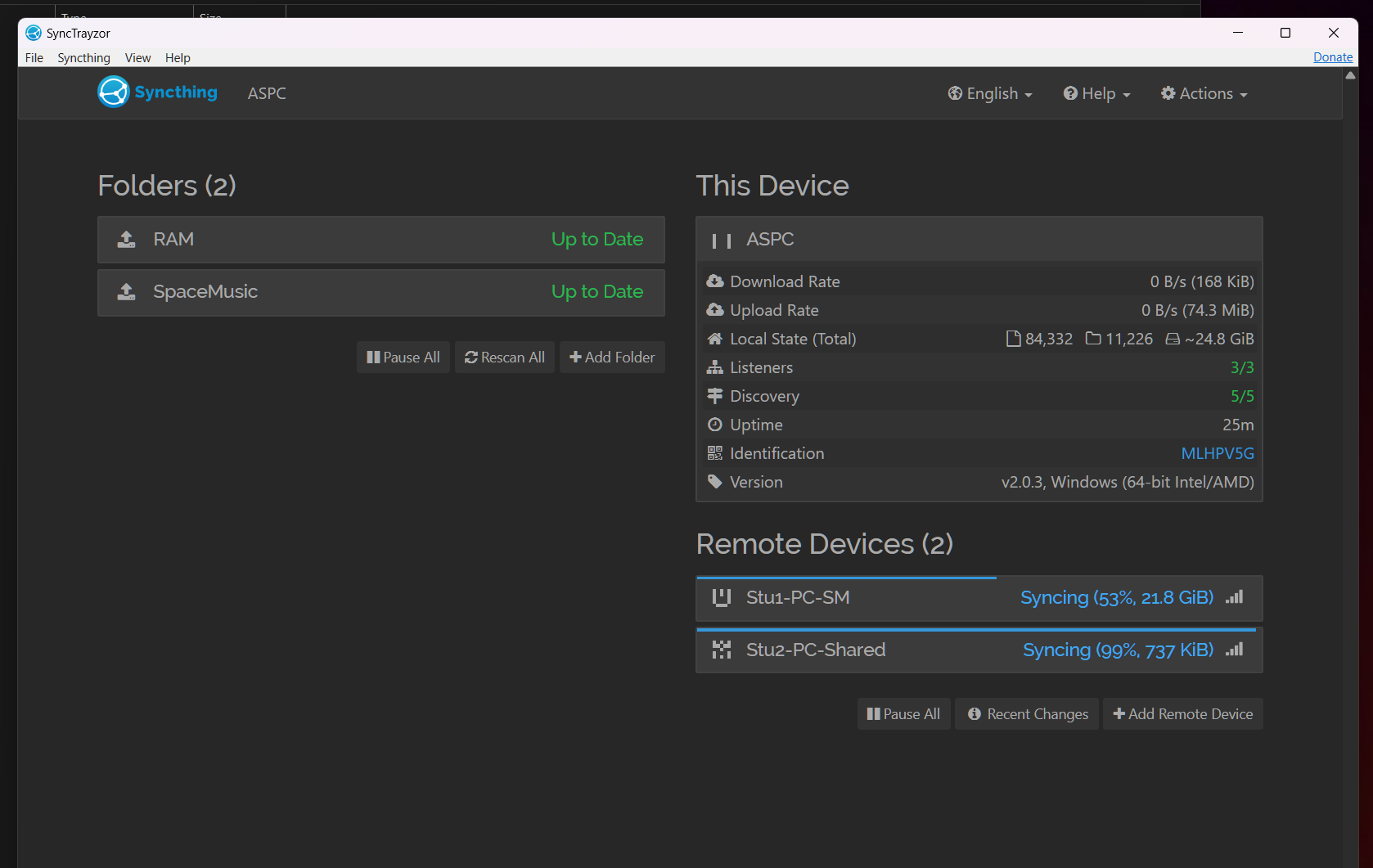

Everything is working fine, but somehow on the source it always says the progress is 53% and 99%.
Where do these numbers get saved? Its obviously not asking the receiver for the status, because then it would see that it is up to date. It must save the progress somewhere and then I think the network connection got interrupted (someone accidentally unplugged the switch). Since then it doesn’t seem to update the displayed progress, even though it is synching just fine.
  • Why is the local state of Stu2 46,5 GiB (vs 24,8 on ASPC/Stu1)?
  • RAM on Stu2 is not receive only yet
I am excluding a lot of stuff on the source. The “source” folder on ASPC is 88GB, but I am only synching 21.7 of those. One one PC (Stu1-PC-SM) no additional data is added yet. On the other PC (Stu2-PC-Shared) some stuff was already added to the folder, but it is only receiving.

I have now also set Stu2-PC-Shared to Receive only, but it still shows the Global State as being 43.4 GB.

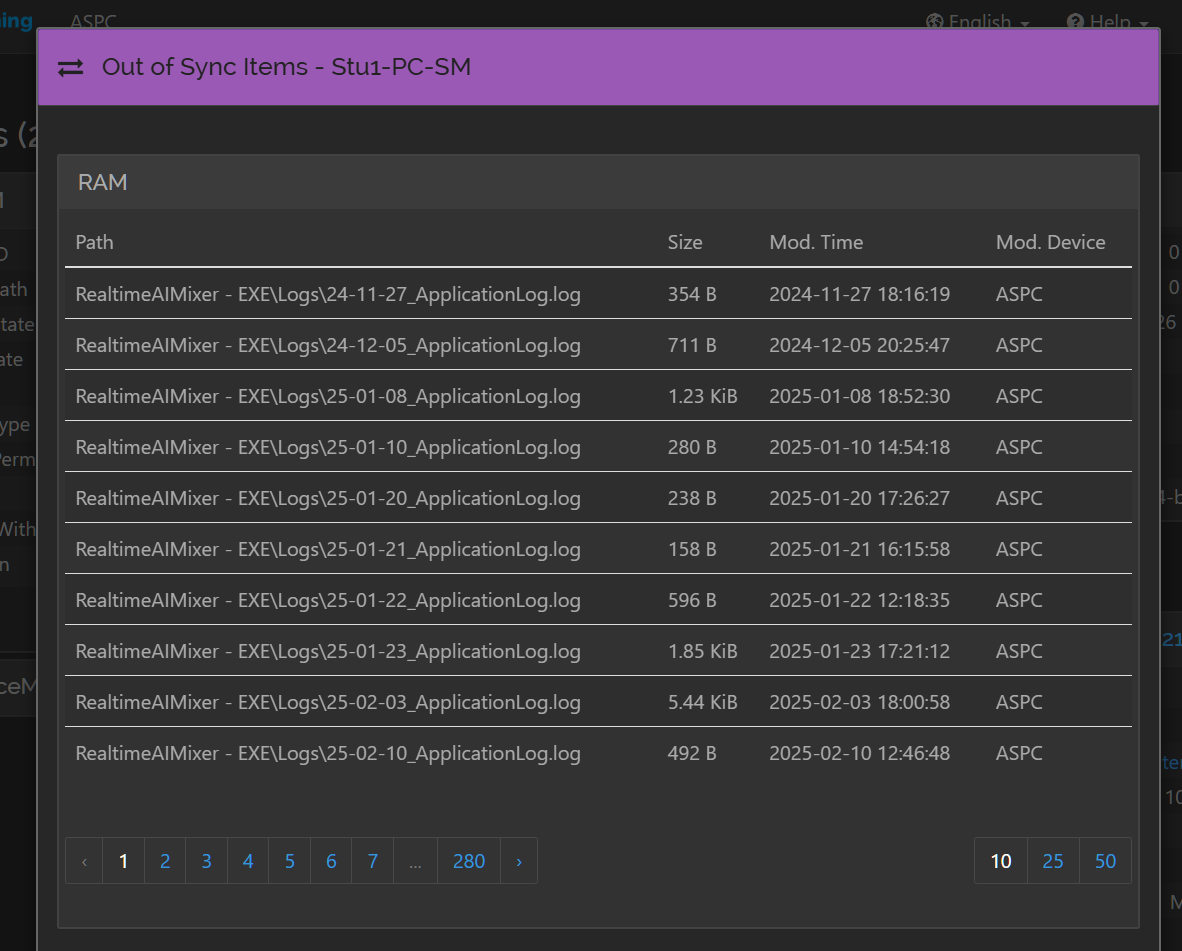

If I look at the out of sync items, they are all files that are ignored:
So I think that is the issue. It’s saying some items are out of sync even though they are ignored!? How is that possible?
Ah yes, just as I thought:

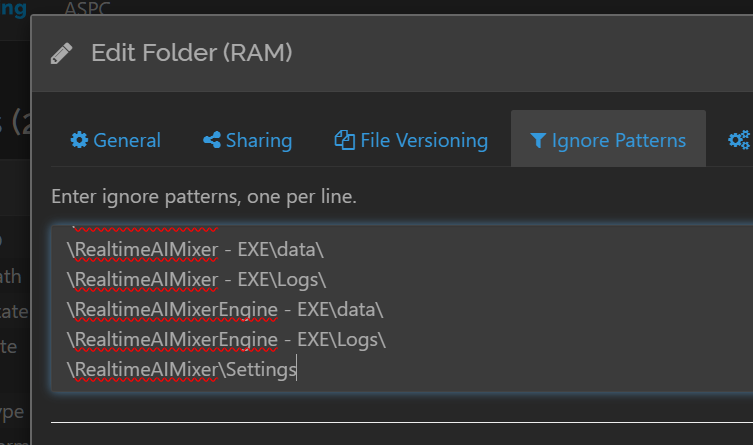

If I ignore the same folders on the receiving end (Stu2-PC-Shared) as on the sending one (ASPC), then now it is marked as up to date.
So its wrongly assuming that it needs to sync files back to ASPC, even though it is set to receive only and the folders it is trying to send back to ASPC are ignored there anyways.
