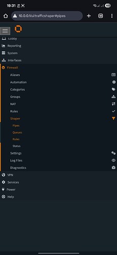

I was just about to ask what firewall you sre using. You need to QoS that badboy. Or there might be a way to limit wihtin Syncthing these days.
You need to use pipes
