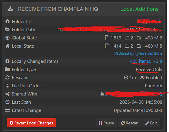

Hello Jakob, Thank you for your feedback.
At the moment, we have set up the SEND folder as SEND ONLY and the RECEIVE folders as RECEIVE only. So it kind of works.
However, as you see in the screenshot, Syncthing detects local adds.
The problem is that after a while, when you have too many local additions, it shows as “desynchronized”.
We wish to use Syncthing to monitor that the files are transferred correctly. Unfortunately, this means we can’t because the synchronization status is bound to be failed after a while.
