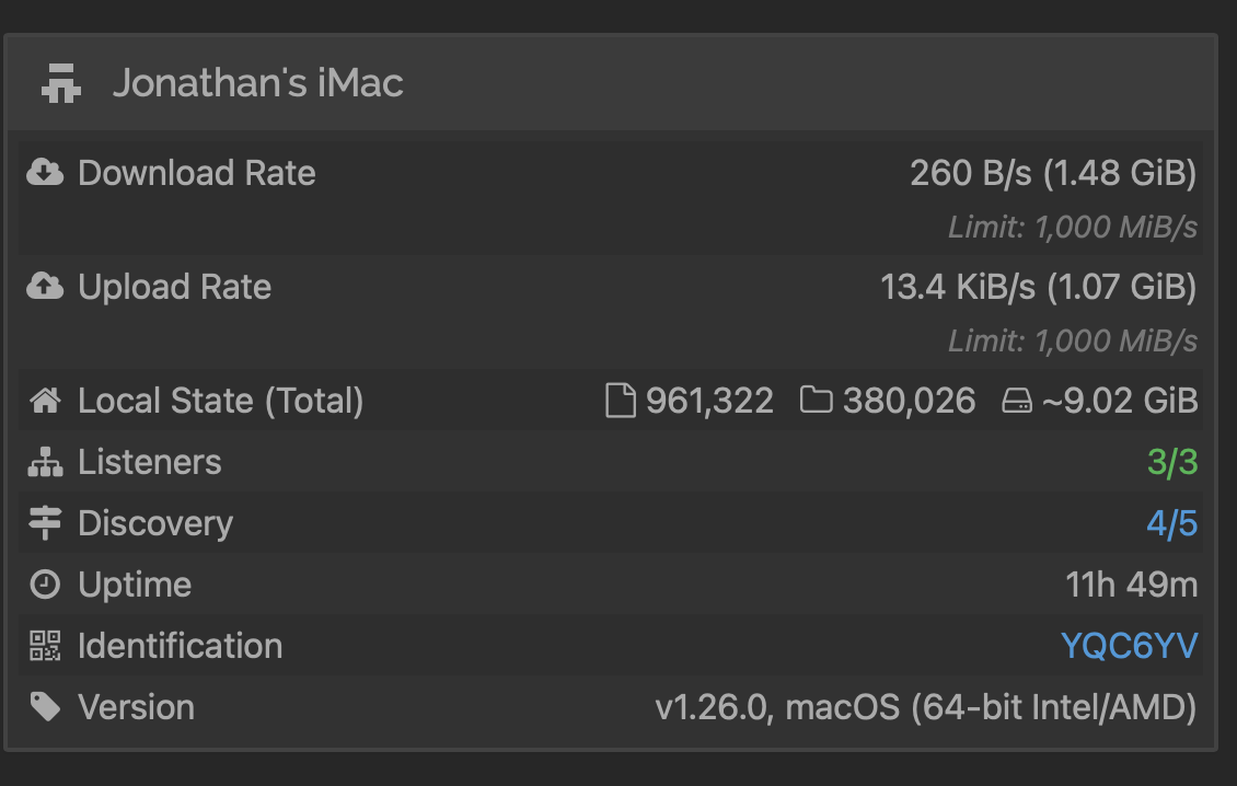

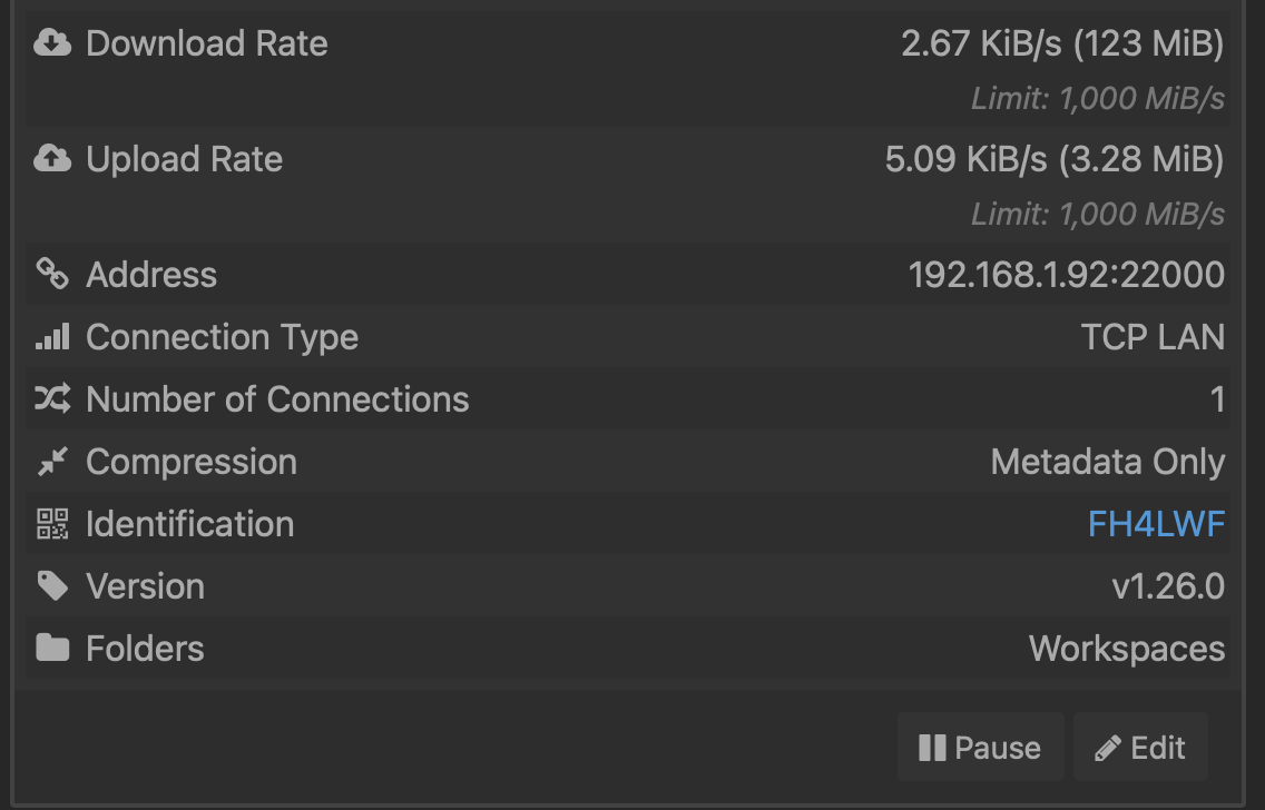

There are still quite a few variables in play, so it would help to see screenshots from Syncthing’s web UI of the remote device panel from each Mac.

update: i removed 1.2M files and things sped up to about 10-20KiB/s. maybe it’s just the sheer number of files. however, i also notice that some devices have only 1 connection even though i specified 20-50 connections.

From the screenshots, the network connections look fine with only LAN connections.

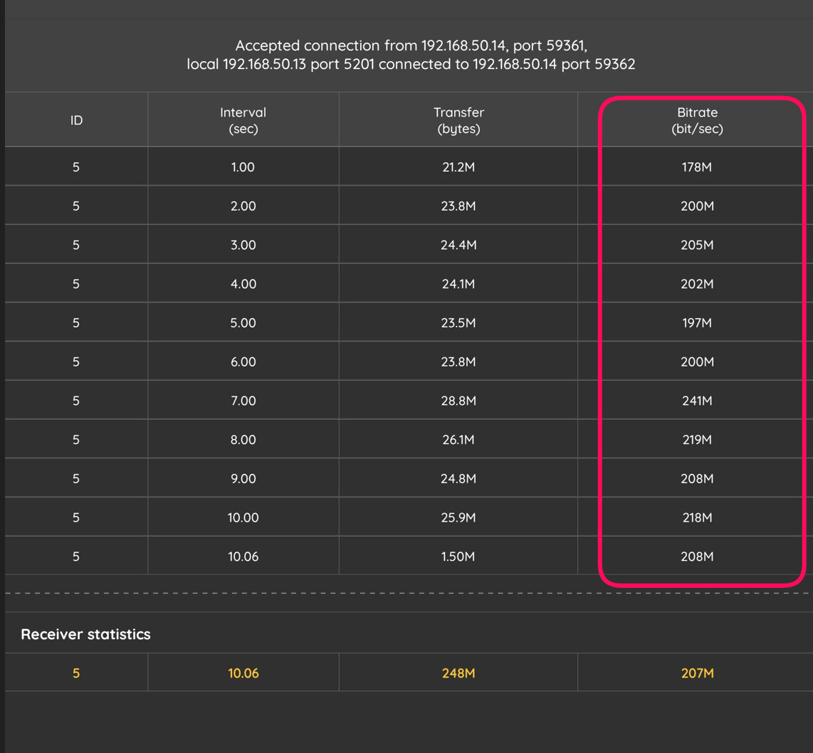

Have you run any network tests to verify that there isn’t an issue with the LAN itself?
I recommend downloading and using the iperf network bandwidth test program on each computer so you can test the maximum throughput that you can get from one machine to the other using a standardized test program.
It comes in a command line format and you run it on two machines one is the server and one is the client and then you can reverse them.
You can download iperf here.

I just like to be sure that there is nothing unrelated to Syncthing causing transfer issues. This test will either confirm there’s nothing wrong with the network connections, or it will expose a problem unrelated to Syncthing.
The test covers the speed of transfers. (Last column in pic.)
It only takes a few minutes to run the tests.
