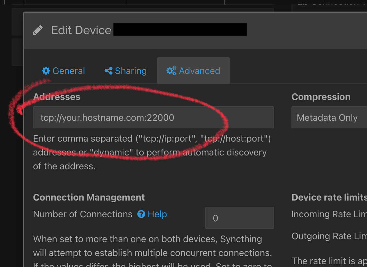

If it isn’t, and you want to proceed I would suggest putting the hostname for your homelab machine into the device config on your university machine and bypass discovery. Also make sure relay is disabled and the port is forwarded on your home router to your homelab server.

Why do you need to run discovery or a relay? One machine is having trouble reaching another machine that has a DDNS resolveable IP address. Forward the port on the router. Specify the hostname of the homelab machine on the university machine config, and done.
what am I missing? I think you’re making it too complicated.
