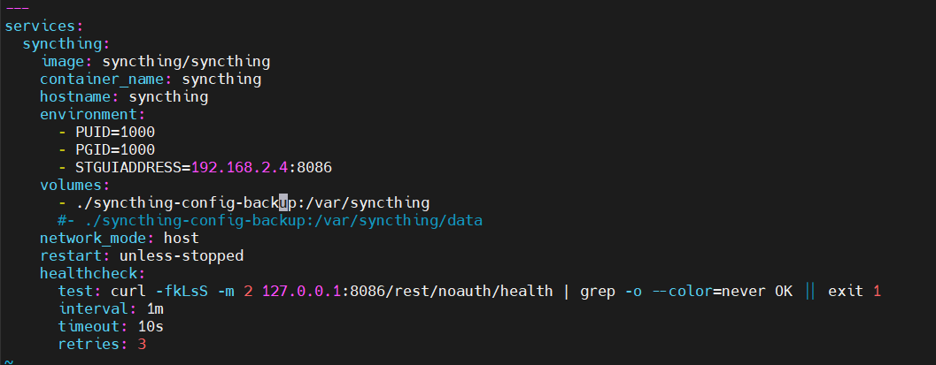

I am trying to restore from a previous instance. I have the following files backed up from the old instance: cert.pem config config.xml csrftokens.txt https-cert.pem https-key.pem index-v0.14.0.db key.pem. I am now running syncthing in a docker container. Here’s my compose file:
services: syncthing: image: syncthing/syncthing container_name: syncthing hostname: syncthing environment:

Here is the docker-compose file:

You’re binding to a specific LAN address, but your test command targets 127.0.0.1. Either change your listening address also to 127.0.0.1 or switch to 0.0.0.0.

Your YAML file has the following bind mount declaration:
volumes:
  - ./syncthing-config-backup:/var/syncthing
The relative path ./syncthing-config-backup is fine, but then you’ll have to be in the parent directory when you start the container.
