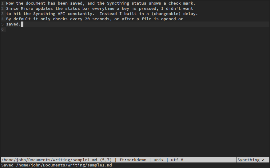

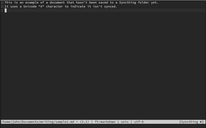

Thank you very much for that info. I got my python script working and when it’s all finished maybe I’ll post about it here. What I’m doing is writing a plugin for the Micro text editor to show a file’s sync state in the status bar, so I’m also learning enough Lua (which Micro uses for plugins) to get it done. I’m doing my script in Python because the stripped down Lua that Micro ships doesn’t have any JSON processing libraries, but Python does.
@calmh Since my scenario is mainly “this computer is mostly offline” I decided to only check the availability list. I see in the Syncthing API docs that remoteneed is an expensive call, is that because Syncthing tries to communicate with the other devices?
I attached examples of what the sync status looks like in Micro - so far I’m pretty happy with it
No, this has nothing to do with communication (this information is available independently whether the device is online or not). Rather, it involves a bunch of database churn to compute this information. [Syncthing does not usually need this; syncthing usually works in a pull-fashion not a push-fashion, so a local device does not need to know which files a remote requires for sync to succeed. The way state is stored makes lookups for remote devices slightly more complex. For comparison, see the SQL statements for remote devices need vs local device need. However, I believe the performance remark was added long ago, prior to the SQLite migration, so the performance difference may be less severe these days.]
Thank you for your explanations on the API , I finished my plugin for the Micro text editor. Code is at johnwoltman/micro-syncthing-status: A plugin for the Micro text editor that provides a file's Syncthing status in the status bar. - Codeberg.org. What I ended up doing was writing a Python script that takes an absolute file path and checks it against the local Syncthing to see its status. The script prints out one line statuses (like “synced”, “unsynced”, “unknown”, etc). Whenever Micro needs to check the status it calls the Python script and puts the Syncthing status in the Micro status bar. It’s a bit barebones but it works for what I’m doing.
