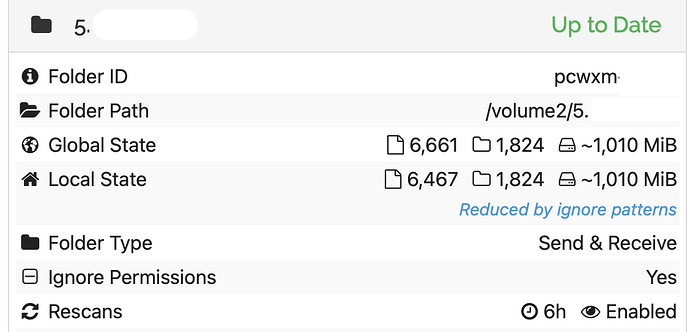

I’ve only unpaused a couple of folders so far, and it does largely appear to have fixed the original issue. However, I’m now having the same problem as in Global and local state mismatch (v2) on each of these folders: the folder says it’s Up To Date, but the Global State is inflated compared with what it should be:
It looks like you’ve already identified this regression - but I don’t believe the steps that lead to this example are the same as in that other thread. (Certainly, these folders have been syncing fine for some years.)
Please let me know if it would be helpful to send you the database - but I appreciate that, as the database was clearly questionable before the upgrade, this may not be very useful!
This is currently expected I think, while there are files that have been ignored. Fix is in the works.

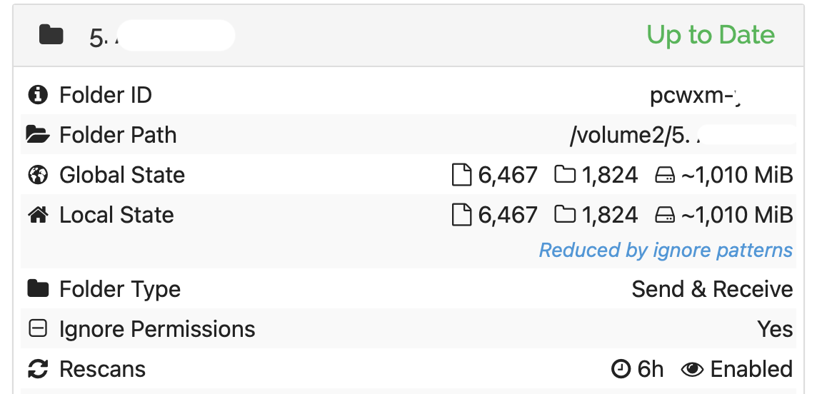

See if .rc-21 doesn’t resolve this for you, please :slight_smile:
Bingo!
Thankyou so much @calmh and @imsodin - looked like a hairy, wide-ranging PR for that!
