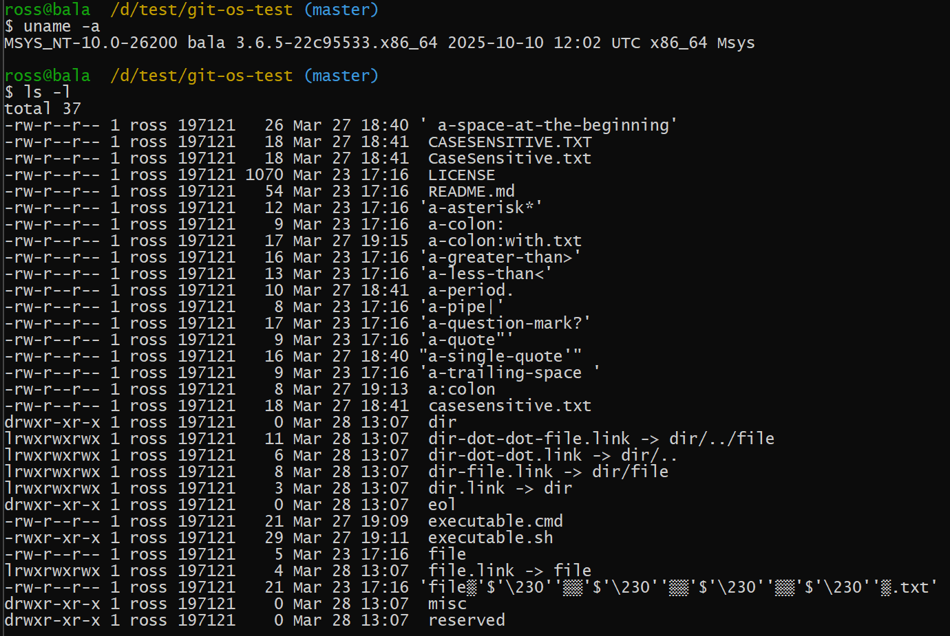

Here’s a proof of concept you all might enjoy seeing. I used this folder dialog:
(built from merge/9539-9623-9266-tbd1-and-8002), to sync all files in https://github.com/rasa/git-os-test from a Linux system, to a Windows 11 system (except for ‘a-backslash\’).
Here’s a listing of the synced directory in a Git-Bash shell on Windows:
The four feature branches that comprise this work are:

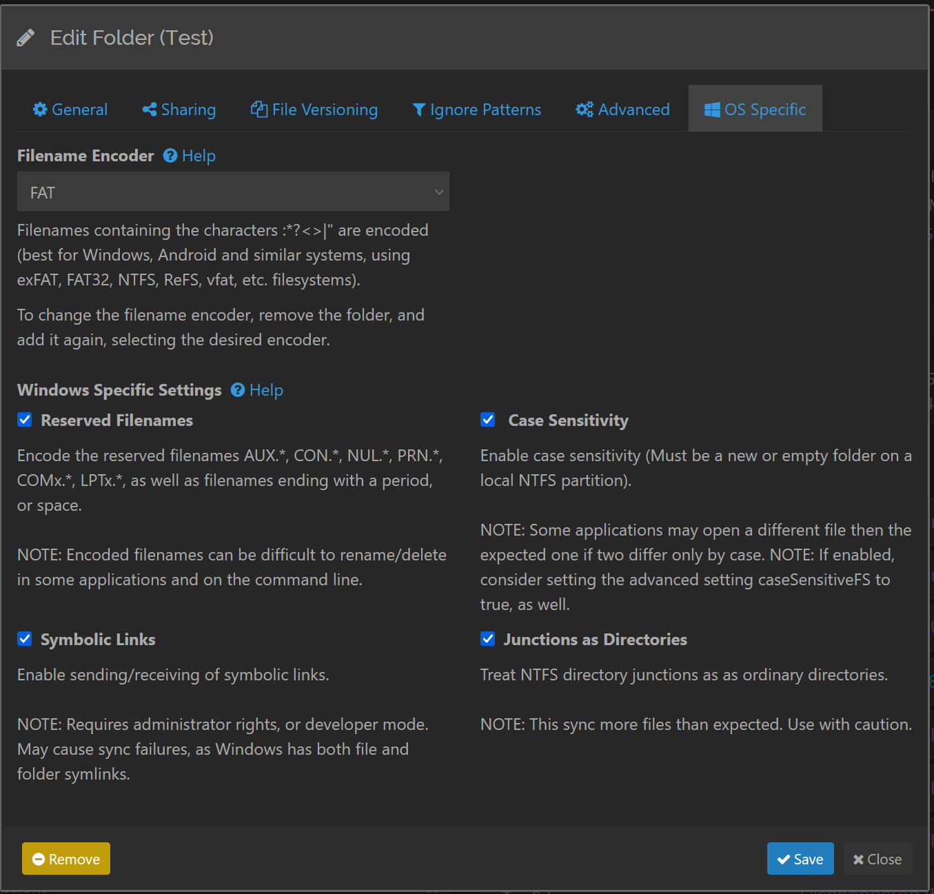

I’d consider adding all that as a separate section under the “Advanced” tab though (especially since some of these are very specialised and shouldn’t really be used except for very specific needs :sweat_smile:).

OK, I will move the settings to the Advanced tab.
I tried adding
ng-if="version.os === 'windows'"
to only show the tab on Windows clients, but it doesn’t appear to work. Any ideas?

Per @tomasz86 ‘s suggestion, I will move the Filename Encoder setting to the Advanced tab. The other settings, I would still like to hide for non-Windows users, but I’m not sure how.

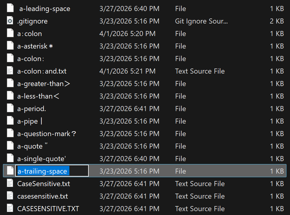

Here’s a screenshot in Windows Explorer:
