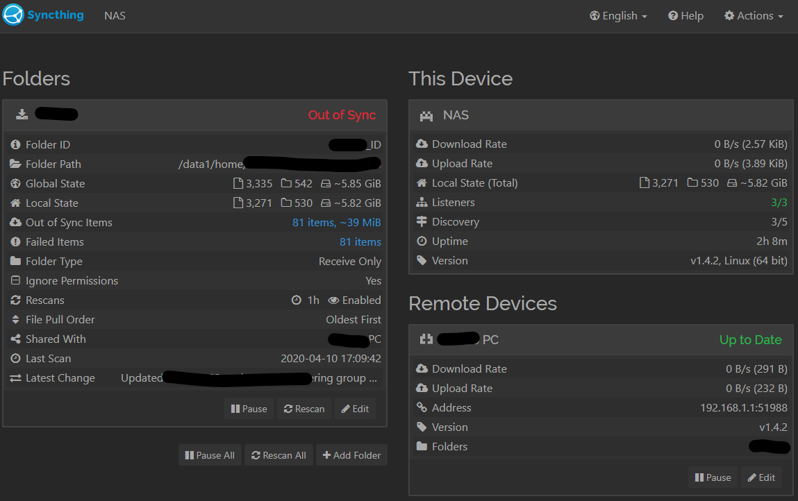

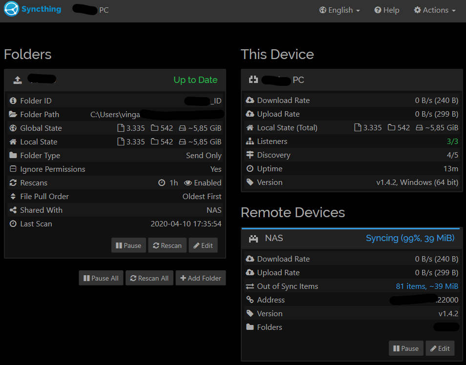

Please post screenshots from both sides.
This is from my NAS:
This is from my PC from my job:
It has 81 failed items, looks pretty clear why it’s out of sync?
yes, I just trying figure out why the sync process is having problems, at least there is a connection between both syncthing app so is not a connections problem. But as I mentioned before, the only different between this states and the previous one was I updated the app to version 1.4.2 in different days.

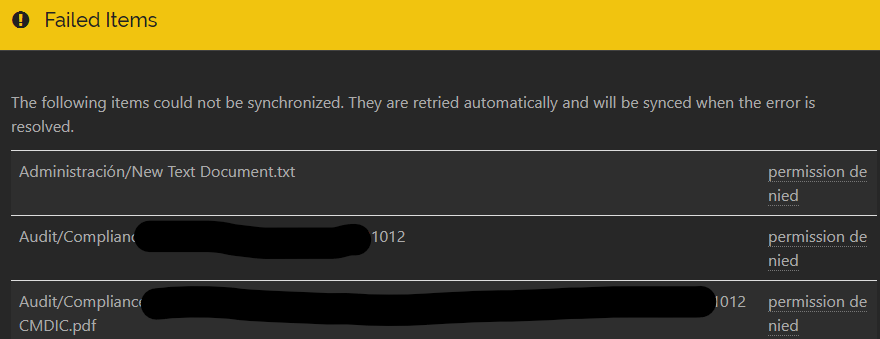

Click on the “81 items” link after “failed items” and it will try to tell you.
Hi Jackob, well… the reason is clear:
It is permission issue at the NAS side :neutral_face:
I was checking my setup after that, and I do not recall that I did some changes in my setup. Where should I put my eyes?
Check that the user Syncthing is running as on the NAS has permission to access those files (and the parent directory).
