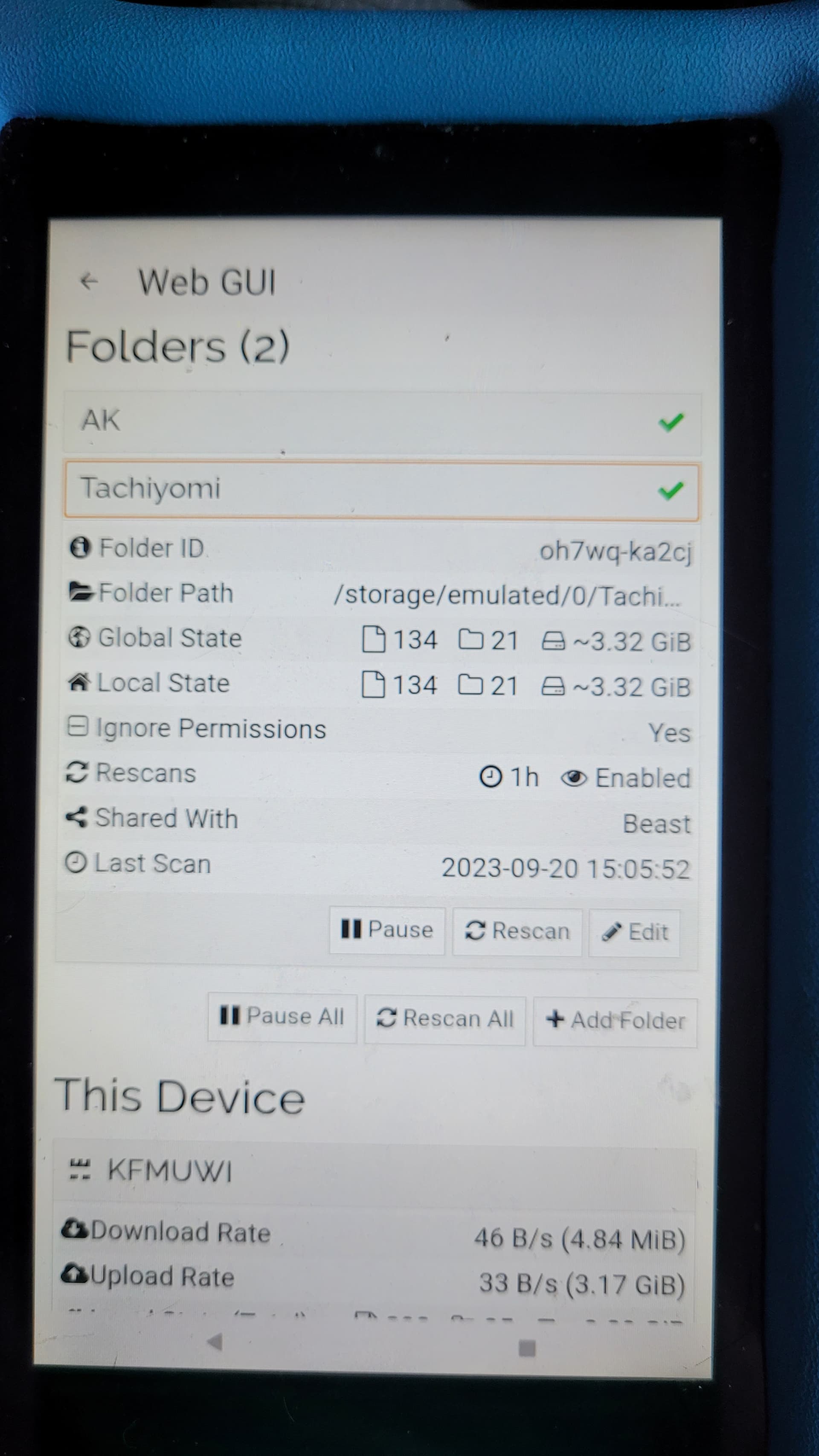

Please post screenshots showing the Syncthing Web GUI in full on both sides.
And here is the client
Let me know if you need more.
On Android, please open the Web GUI using the left slide-out menu and take a screenshot from there.

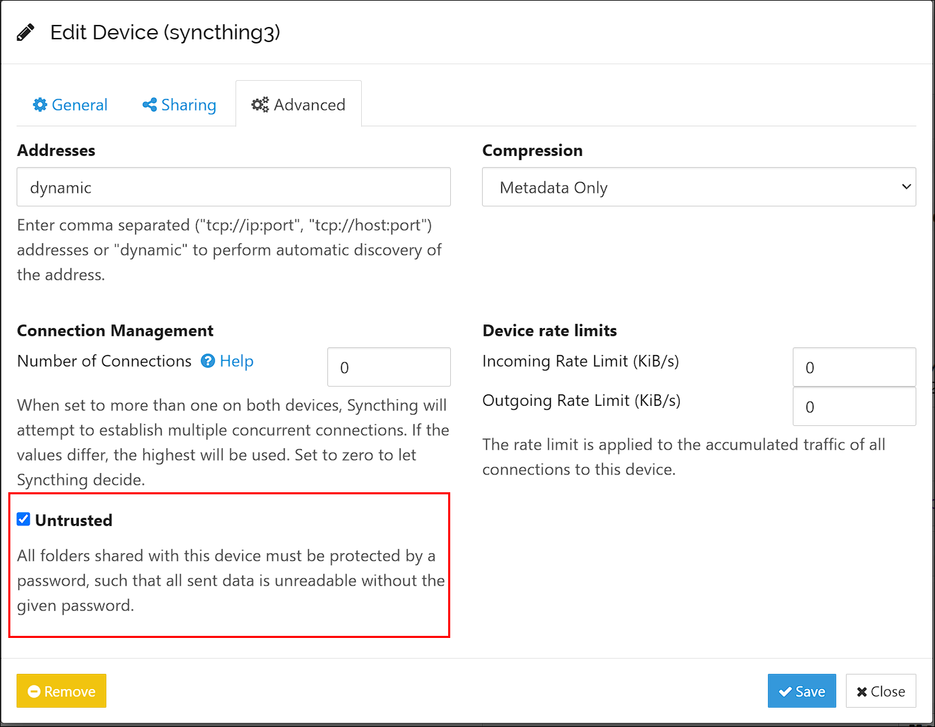

All looks normal judging by the screenshots. Not sure why it errors out. Is the remote device on either side set to “Untrusted” by any chance? You can check this when you click “Edit Device” and go to the Advanced tab.

I didn’t see anything about trust in advanced.
If it’s enabled, then you should disable it and remove all the passwords. All those are only needed if you want to share your folder password-protected and store it in its encrypted form using the Receive Encrypted folder type, which doesn’t appear to be the case here.

Both sides have the untrusted unchecked.
