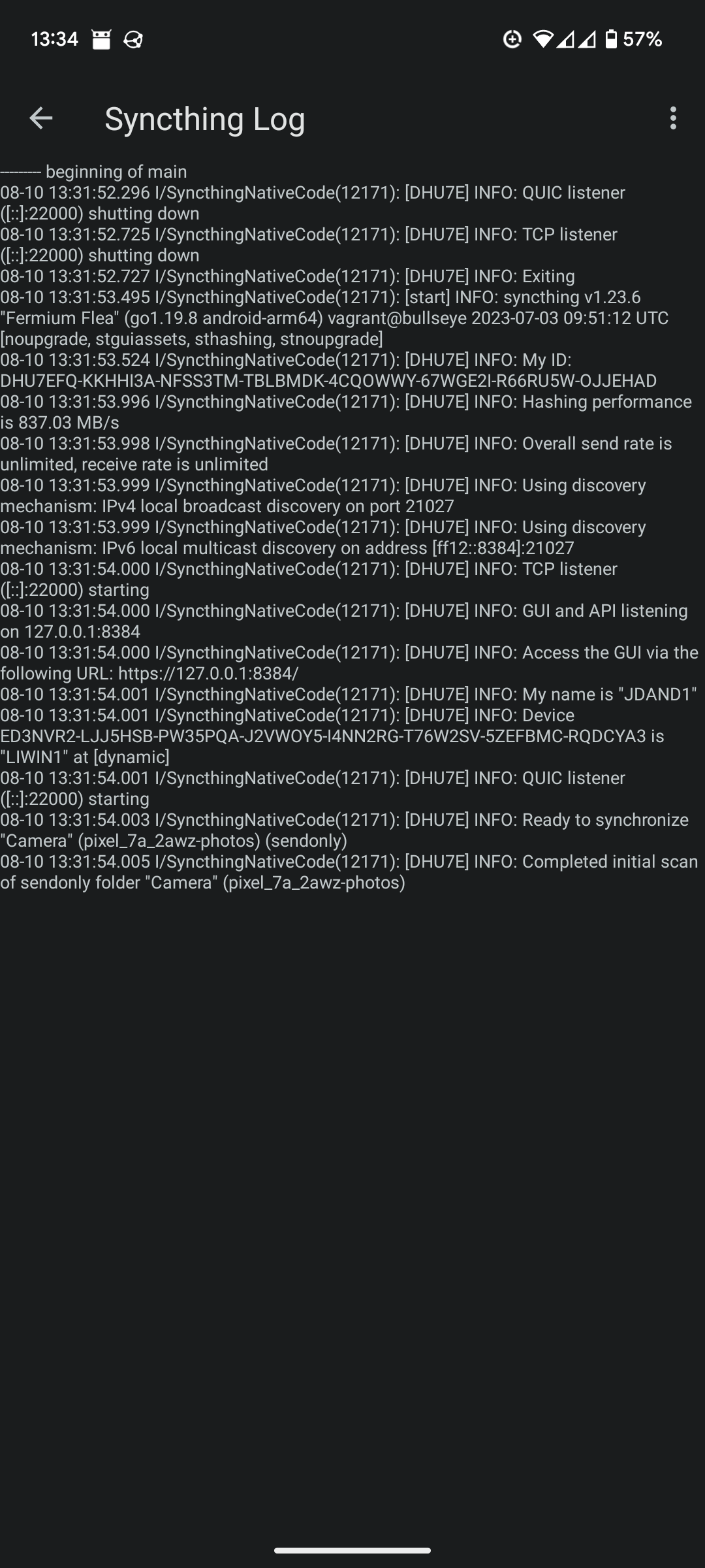

Here is the screenshots of my logs from my device:
The default already covers 0.0.0.0 so this isn’t going to do anything (see https://docs.syncthing.net/users/config#listen-addresses). I would suggest to restore the setting to default for now.

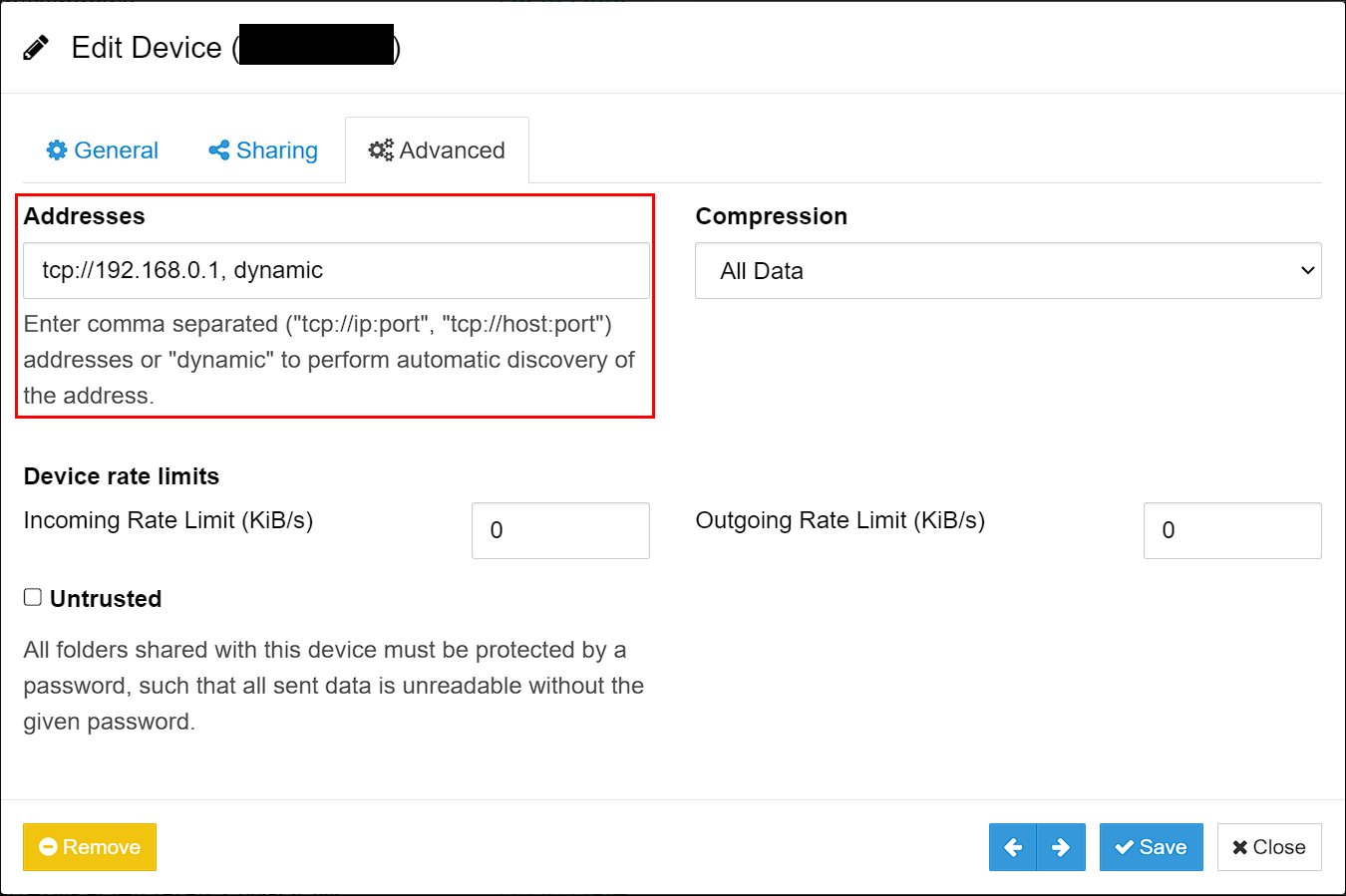

Can you include more details about what you’ve done here specifically? Do you mean something like this?
If yes, then doing so should indeed help the two Android devices connect with each other quickly, as local discovery is broken, however global discovery is also supposed to help with LAN connections by broadcasting local IP addresses as well. In the worst case scenario, the devices should still be able to connect through a relay though.

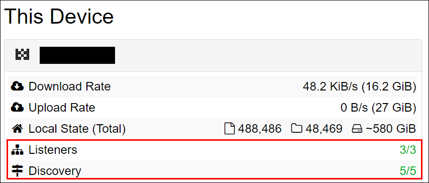

Can you open the Web GUI using the left slide-out menu in the Android app, and then post screenshots of what you see here on both devices?
