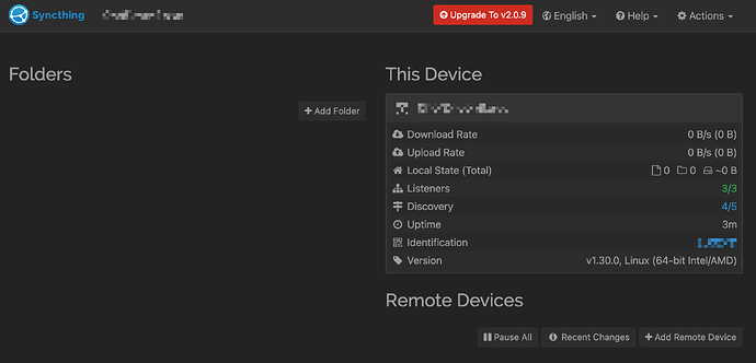

Running the (community build) of Syncthing v1.30 on my Synology NAS (old arm-based, low RAM system) - I am wondering about the best way to upgrade to version 2.0.
Background: Autoupdates seem to be disabled for the upgrade to version 2.0. In the GUI of Syncthing, a red upgrade button appears: “Upgrade to v 2.0.9“.
Doe anybody have experience with the upgrade to v2.0 on Synology (community build)? Is it considered to be “safe” to upgrade via the upgrade button - or is it recommended waiting for a new community build?

Set up Syncthing today on a newly-formatted Synology NAS running DSM7, and upon login I am greeted with that tempting red button… but fairly sure I should not press it.
Yes, upgrades to v2 don’t happen automatically. And the SPK package for Synology DSM is deliberately not shipping version 2 yet, waiting for some more stabilization.
Frankly I haven’t even upgraded my DSM Syncthing yet myself. I do expect some troubles because of low RAM, so will be waiting until the new version has matured a bit and I have enough spare time to handle any upcoming difficulties after starting the migration. I’d recommend pausing all folders and devices for sure before attempting it.
Upgrading via the internal updater (button in the GUI) is definitely the correct way if you want to try it. No need to wait for a new SPK, as the supporting scripts should be compatible with v2 already. I haven’t tested though.

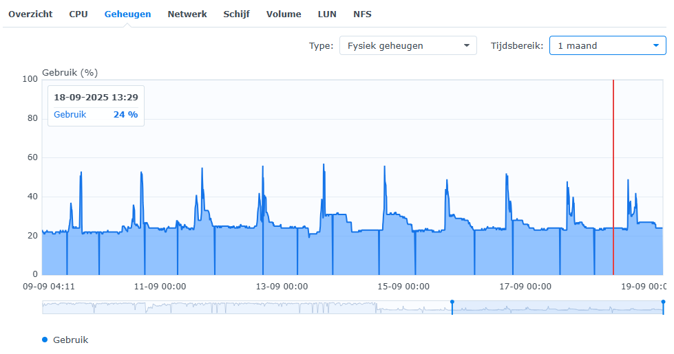

RS422+ with 2GB RAM is happily syncing folders holding a few TB of files on v2.0.9 and memory usage is reasonable. It absolutely requires the database to be on an SSD though.

For reference, on an RS422+ with 2GB of RAM, that syncs 4 TB of folders (550k files) that are now settled:
I did tune the folder concurrency setting when migrating, but that was with the older slower versions, and seems not needed anymore with v2.0.9.
