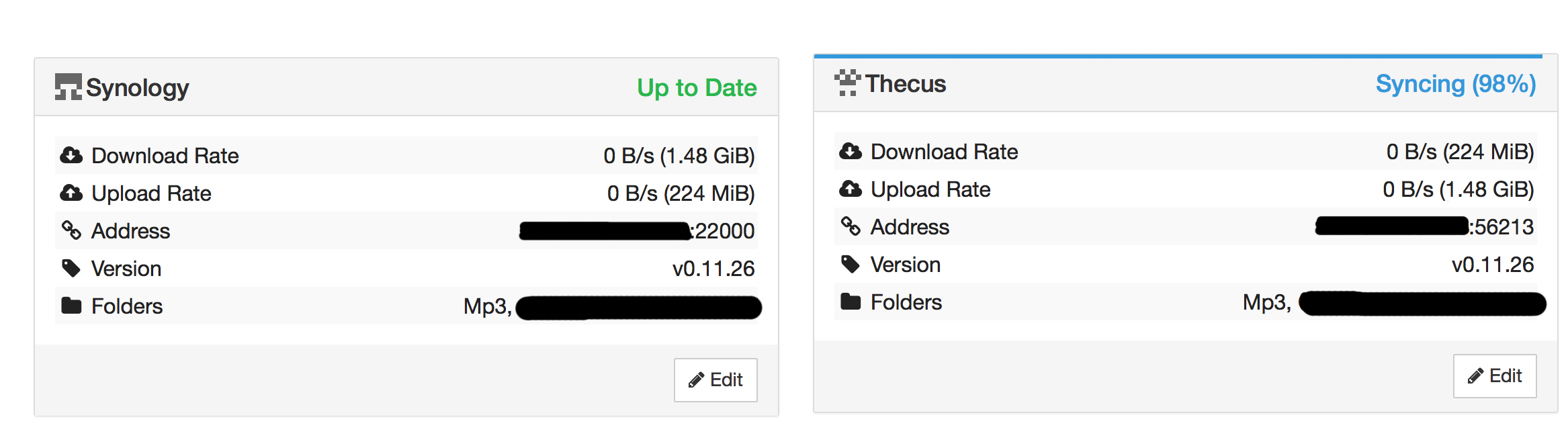

I just setup two computers to sync between each other I disable the Upnp in booth machines and in booth routers and open the respective ports of course.
My question is why even Upnp is disable one of the address always comes with a random port and not the assigned one 22000
In booth machines i have the Addresses:22000
But one they connect one always uses a random port and not the designated one.
Thanks for your advice
Are you getting confused between source and destination ports? Where exactly do you see port numbers that aren’t 22000? Copy/pasting log messages / whatever you’re seeing would be very helpful.
You see the Synology has ip:55360 Why ???
The thecus has ip:22000 this is fine.
Thanks
One is a listening port (incoming), the other is a connecting port (outgoing).
The listening port is defined by the listen address, the connecting port is randomly chosen by the OS at the point we try and connect (if we fail, it gets closed and OS uses a different one).
In this case Synology (random port) connected to Thecus (listening port), this is how TCP works.
