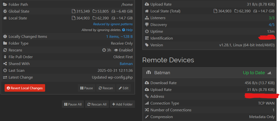

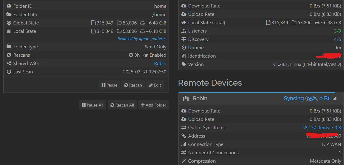

I have 2 servers: Server A and Server B
Server A is Send Only Server B is Receive Only
If i delete a file on Server A, will it also delete on Server B?
The issue we are having is the local state has almost doubled on Server B and we are seeing files that DONT exist as they have been deleted on server A, we can see these on server B.
This has also caused a huge out of sync files too.
This is Server A screenshot.
This is Server B screenshot.
Edited files are syncing, new files are syncing. Files that are deleted on Server A are not deleting on Server B.
Thanks in advance!
UPDATE:
Server B had ignored delete file checkbox enabled under advanced settings!
All fixed.
