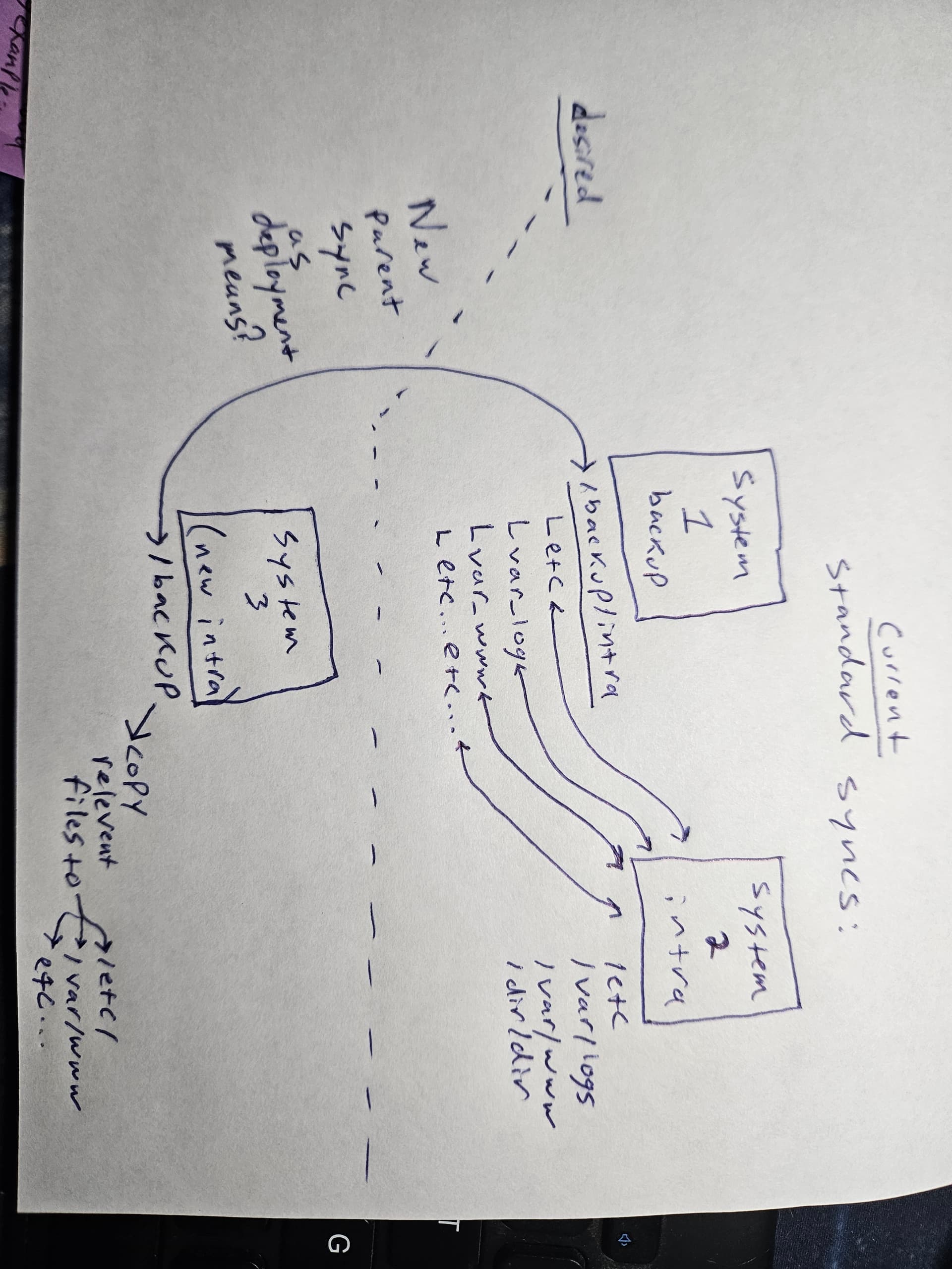

Here’s my best attempt at a quick diagram: (sorry that says “desired” in the top left)
So basically I would have parent and children on in Syncthing on the backup machine, parent being nothing but the directory that contains the synced children(no other files, etc), then I would sync that parent like a deploy package to the new machine, I would copy necessary files (data files and system configs - no Syncthing files will be transferred). After the files of interest are transferred I delete the sync from Syncthing UI on the new machine and remove the directory entirely (with all subsyncs inside).
So I really am only using that sync to deploy, then it goes back to “unshared” on the backup machine and serves only to aggregate the syncs it contains, but is never shared or synced outside of backup machine again.
I will then use my previous config.xml for syncthing, delete the old direct syncs from backup from UI and remove synced directories, reshare them fresh from intra as though it was the first time, and let them sync normally back up to the backup machine. Again versinoing will only be on in the new “subsyncs” and all old versioning data will be gone.
I hope that helps - THANK YOU!
