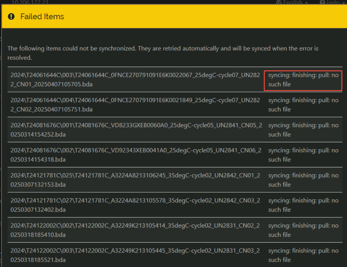

“Pull: No Such File” Error

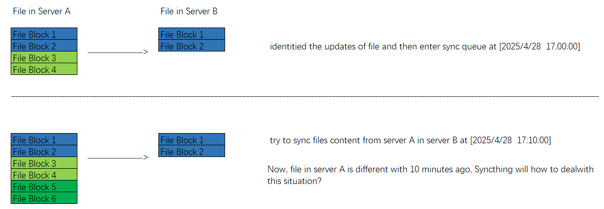

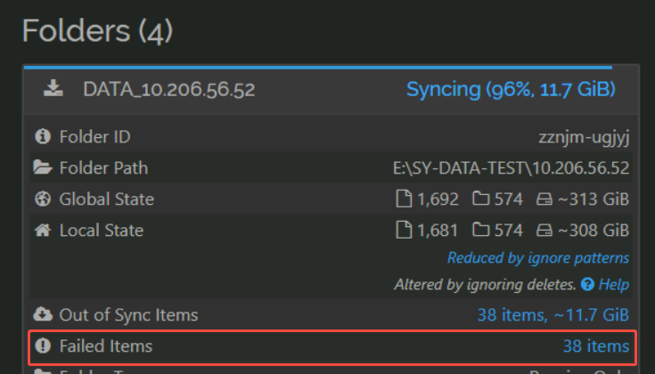

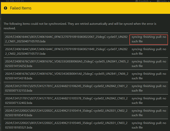

I sync some files from server A(10.206.56.52)to server B (10.206.122.21). Files in server A updated frequently, so I encountered many problems as above.
I just wonder how can I avoid this problem, could you all tell me how to fix it. Thank you all.
You can ignore those, but generally, the problem happens because the files in question either get deleted, moved or renamed on the remote device before they finish downloading. If that occurs while still downloading, the temporarily downloaded partial files will automatically be deleted later.
You may want to play with https://docs.syncthing.net/users/config.html#config-option-folder.fswatcherdelays and set it to a larger value, e.g. 60 (seconds) instead of the default 10. This will delay the sync once Syncthing detects the files, so if they disappear within that time period, it won’t even try to push them to other devices.
Just to be clear, you need to change the value on the device, which creates the files.

It’s going to be a very rare situation that a file just got a couple of complete blocks added. More likely, if appends are happening, “block 4” is going to be different from step one to step two (like, 100 KiB in step one and a full 128 KiB block in step two).
If the situation is precisely as you describe, which it probably isn’t, then it will indeed sync since the blocks it knows about will match.

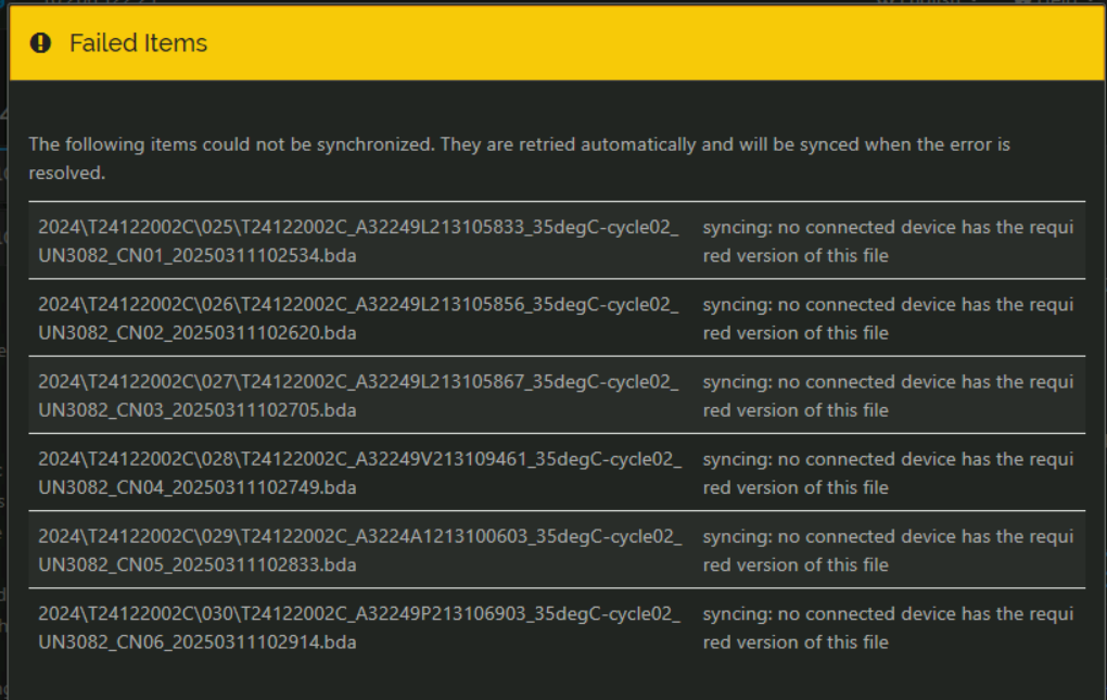

I’d like to know, if the file is written into 24/7 with no breaks, could you optimize sync mode to that just base source file’s status that when syncthing try to sync the file. Thus, if we turn off [Watch for changes] item of folder, the file will be sync correctly.
We will not encounter error as below:

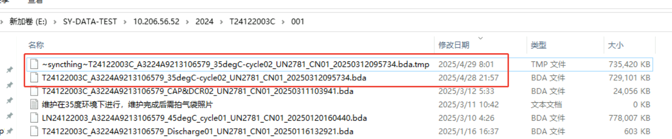

As you see, this is the destination folder, a file is updating continuous in another server (source server), update time of TMP file and real file is big different about 10 hours.
So, I just think, could we figure out a scheme to deal with scene that updating continuously.
Such as, copy source file per 5 minute and then sync this copy to destination file or transform TMP file to real file per 5 minutes.
If this sync mode can be realized, syncthing will be fit our business requirements perfectly.
Could you please figure out better solutions? Thank you for your attention.
