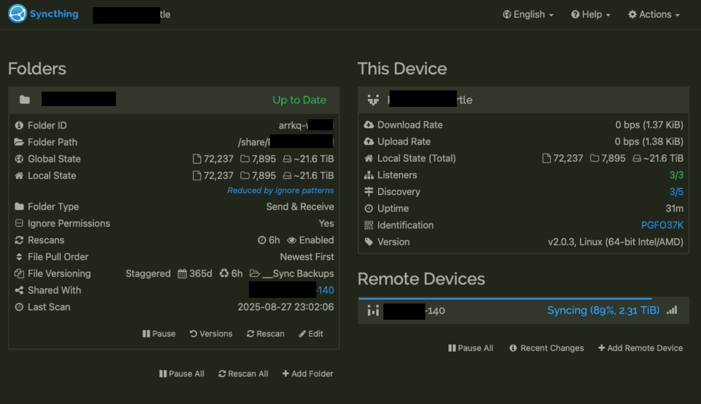

Using Syncthing 2.0.3 on Device A and Device B, sharing a single folder. Both devices have the same Ignore Patterns and are on the same LAN. Device B is 89% synced in the case I’m looking at:

Now I’m seeing:
  • Device A still thinks Device B is 89% synced:

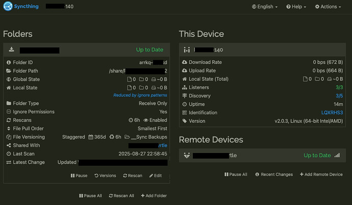

  • Device B appears not to have received any file indexes from Device A:

Hi Jakob:
Thanks - as always - for the quick response. A couple more data points on the original scenario:
  • The Folder Path for Device B was changed when it was re-added (the original purpose of removing and re-adding the folder) - so there would (correctly) have been no local copies of the files scanned;
  • Device B is in Receive Only mode.
Made no difference. Likewise removing Device B from Device A’s list of Remote Devices and then re-adding it made no difference.
Thankfully I have resolved it by removing the folder from Device B, restarting both devices, and then re-adding the folder to Device B. After a few minutes, things started getting back into shape as expected.
Cool. I suspect this is a communication bug more than a database etc bug. That is, something isn’t restarting correctly when a folder is removed/reannounced by the other side, so index IDs don’t get refreshed. :person_shrugging: Can try to troubleshoot that at some point.
Yeah - no hurry from my end!
