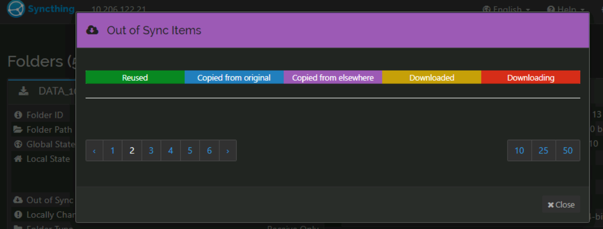

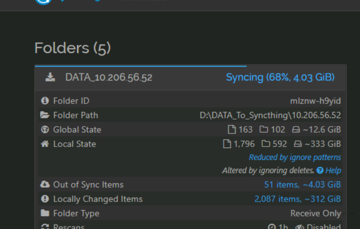

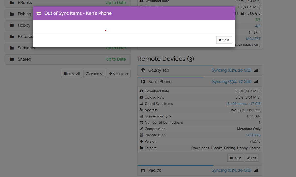

I have some out of sync items as below:
but when I click the link to view it, I can see nothing as below:

I waited about 30 seconds. This error isn’t appearing every time, but if it’s occurred, will continue a long time.

Still shows up as Out-Of-Sync with no actual files being listed.
