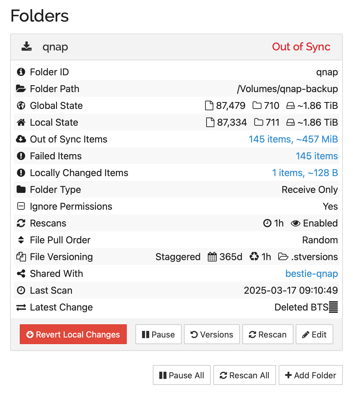

Here’s a folder.
And here’s the result of calling /rest/system/error.
    "errors": null
:frowning: Is there another way to get this status via the API?
FWIW what’s happening here is that my friend has this weird habit of putting a space on the end of a folder name. LIKE THIS . Which causes sync issues between a QNAP and a Synology.
I’d like to be able to detect when she does this and correct it. I’m using Uptime Kuma which is great, and could detect if the API returned a non-20x error code.
But as it is, it returns 200 OK.
