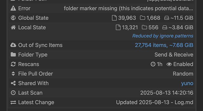

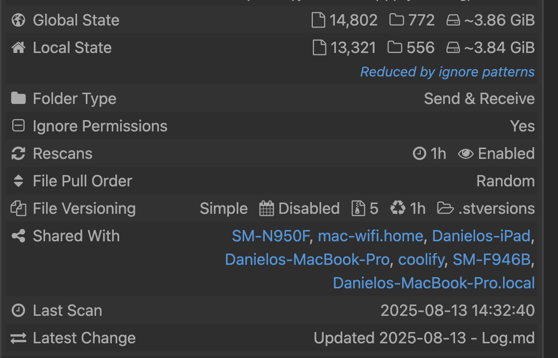

However, today I got a new device I added out of sync with the main sharing server, and I can’t understand why this is.
The new devices claims to have exactly the amount of files it should, but it also says that it is missing a ridiculous amount of files. Check the screenshots for details
This is the main central server sharing with the rest of devices
And this is the one complaining about being out of sync (despite it has the right number of files)
I tried removing and adding the folder, but the result is the same, if not worse than the first attempt
