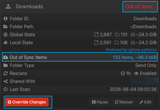

Option to disable the "override" button on a Folder (when out of sync)
When folders go out of sync, there is an “Override” button that shows up.
I want it gone, for some folders.
What I do, is to sync a few things from my Phone to my NAS. Things like Screenshots, Backups, etc.
I do not want these to sync from the NAS to the Phone, only one-way (Phone to NAS), that’s how it’s configured today, it works fine.
Except for this “Override” button that makes me feels like something’s wrong.
I clicked on it yersterday a bit too fast, and erased a folder on my NAS (new phone, no screenshots). (hopefully the NAS has backups and restore was a breeze)
But for these use-cases I’d just want the ability to, from the Folder config, disable the Override ability entirely. (it should be just a “UI-thing”)
Thank you

It won’t fix the “out of sync” status, but it doesn’t need to.
What I’m looking for is a way to tell that Folder “you’ll be out of sync, that is expected, do not ask me to fix it”, which essentially comes down to:
  • Do not show me aggressively that it’s out of sync (I don’t care, nor should I fix it)
  • Do not propose me to “Override” because if I do then that is what will cause issues (I’ll essentially override my “server” with my device, wiping lots of files I actually want to keep)
So, what I’m looking for is more of a way of avoiding myself clicking on “Override” thinking I’ll be solving an issue while there isn’t any really (but clicking on it will bring out issues).
And yes sorry I didn’t bring on the full picture right at the start, narrowed it down to what I thought was sufficient to comprehend my needs, but it wasn’t.
