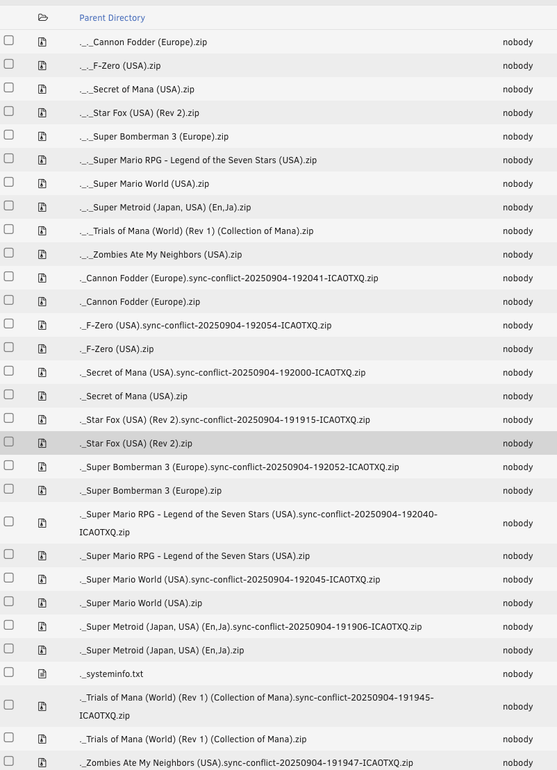

OK here’s a question. When syncthing creates all these ._ files, they get added to my Emulation front end as games, really messing the interface up.
Is there a way to avoid that?
Syncthing doesn’t create such files, they’re likely already there, but you may not see them depending on the file browser settings (as they are usually hidden by default). You do have some conflicts though (see https://docs.syncthing.net/users/syncing.html#conflicting-changes).
Oh, how strange. Never seen those before at all. Perhaps my Unraid server does it for some reason.
Can I put ._* in the ignore pattern box to stop them syncing to my devices?
