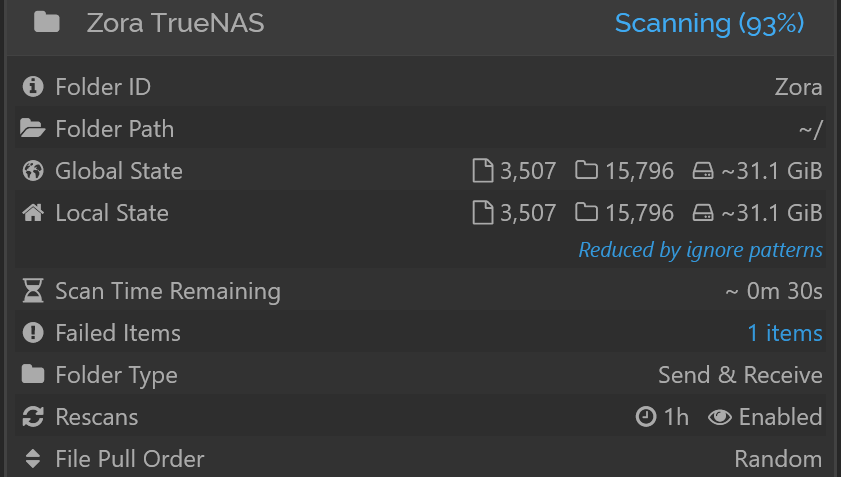

However, this base folder (Zora) was not properly detected. I only notice this after I realize it started syncing all the files and I caught it after about 30gb of files:

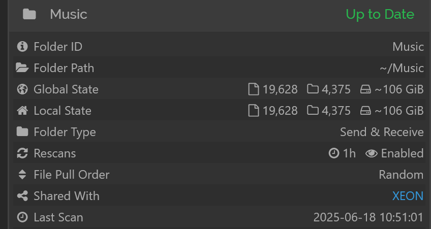

So if that was an issue, subfolders like Music have shown issues.

I have tried to add a / to the base folder path and still ignores all the files I can see via Window Share, but somehow detecting another set of files:
Sorry, I want to clarify that the exact copy of the data exists on both both sides (2.7TB). I did not connect the folders together because I realize that TrueNAS doesn’t see anything locally and brining over files. I stopped it at 30GB. I deleted and readded the folder and it still sees whatever it just synced over instead of the data that already exists. I can understand it’s a pathing issue, but the sub folders are synced up no problem.

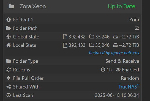

You created a folder on XEON which you gave Folder ID “Zora” and you set Folder Path to “Z:”.

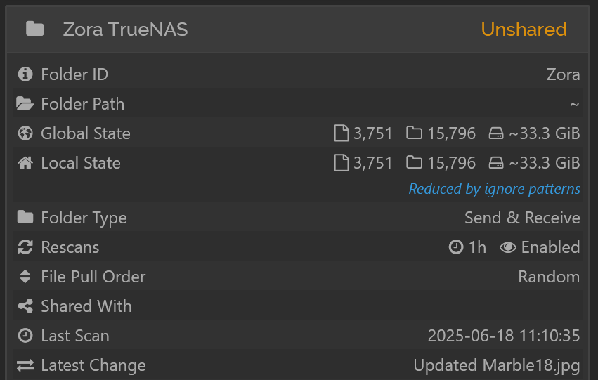

(… and a screenshot from TrueNAS were “Shared With” was empty.)
Since Shared With is empty, TrueNAS folder “Zora” is NOT synching with anything. So the 30 gigs you see is just how far it had gotten in the initial scanning.
What makes you believe it does not “see anything locally”?
If you see my first screenshot of Zora XEON, there are 2.7TB of data. The other screenshots of Zora TrueNAS shows only ~30gb of data after scan.
This should not have anything to do with sharing. Zora TrueNAS not shared with anything should still show that it’s 2.7TB of files locally. Both drives are identical and Up to Date prior to the TrueNAS upgrade. Again, the local subfolders all seem to have scanned and synced up without issue.
