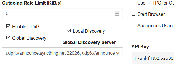

Semi-related question: on one device, I run it with “Automatic Upgrades” de-selected. When I clicked the button to upgrade to the new .22 version, it returned an error saying that access was denied to creating syncthing.exe.old.
So I deleted the ST files in its directory and manually unzipped the new version there. It’s now running the new version, but in settings, there is no longer any checkbox to enable auto upgrades if I wanted to. Is there a fix for that?
Here’s what I see there. No option to set upgrade choice.

This happens if the upgrade check towards Github fails when you load the GUI – i.e. if the upgrade server isn’t available, the option isn’t shown. Perhaps you have spotty connectivity or Github has rate limited you?
(This could probably be handled neater; the reason it does this, is that this is the same behavior that kicks in when the upgrading framework is disabled at compilation time…)
Well, here’s an update. For a completely unrelated issue, I had to restart the PC. Upon restart, I looked again on the browser page and the upgrade checkbox option is now there where it is expected to be.
So that’s that.
