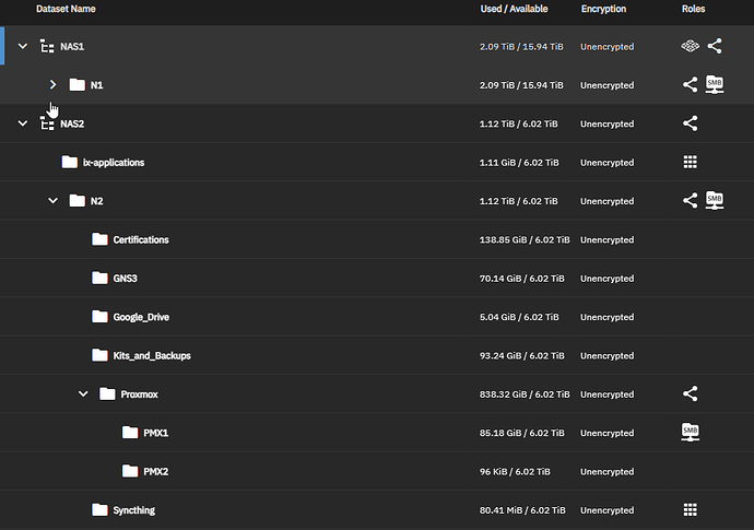

/mnt/NAS1/N1 & /mnt/NAS2/N2 are 2 ZFS pools created within Truenas (proxmox passthrough drives), with N1 & N2 being the main datasets, each with multiple child datasets (some of them acting as SMB shares).

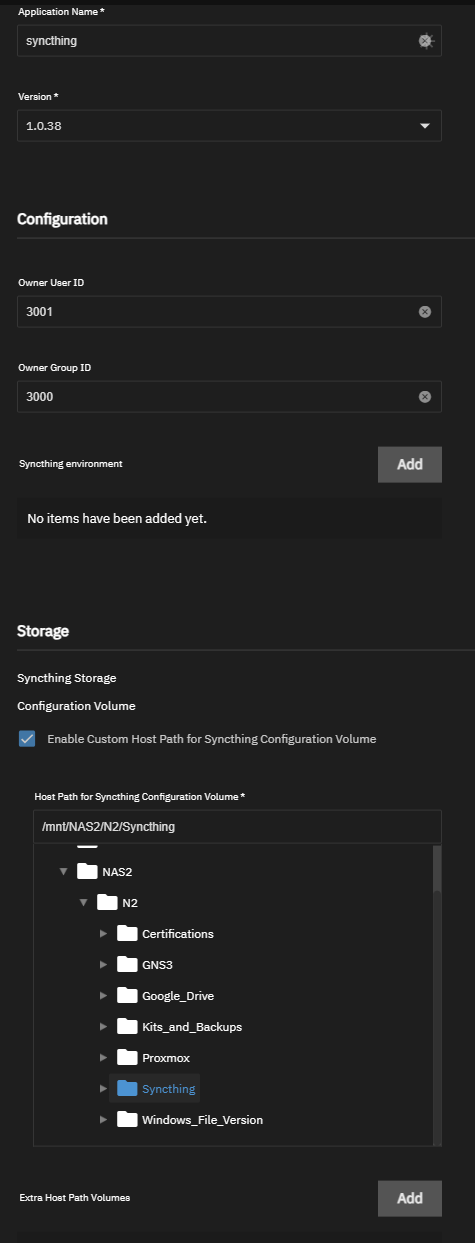

I am using Truenas Scale which is built on Debian (Ubuntu?), not FreeBSD (that’s Truenas Core). It seems to be running as part of a kubernetes pod. Honestly, I’m not familiar with kubernetes, had to learn how to access the pod directly to change the Syncthing certificate, but that worked nicely. From what I’ve seen Truenas asks for a user/group when installing the Synthing. The user I used to create it is the owner of the mount points, so even a 700 permission set should have worked. It’s the exact user that I use on other machines to access (full access) the SMB shares created by Truenas.

This is the setup used, where both the user and the group used have full permissions to the entire paths, not exactly sure how I’d even mount or do a passthrough of the path inside the pod.

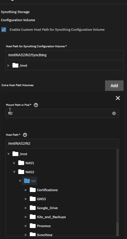

I think you want the “extra host path volumes” at the bottom of the first screenshot.
I’ll give that a shot. I used this as a reference and paid attention to that part. But things have changed since the video was out. How To Setup TrueNAS Scale Apps With Shares For Host Path Volumes - YouTube
Love you man :slight_smile: This seems to have done the trick
After you do that it shows inside the pod’s mount point

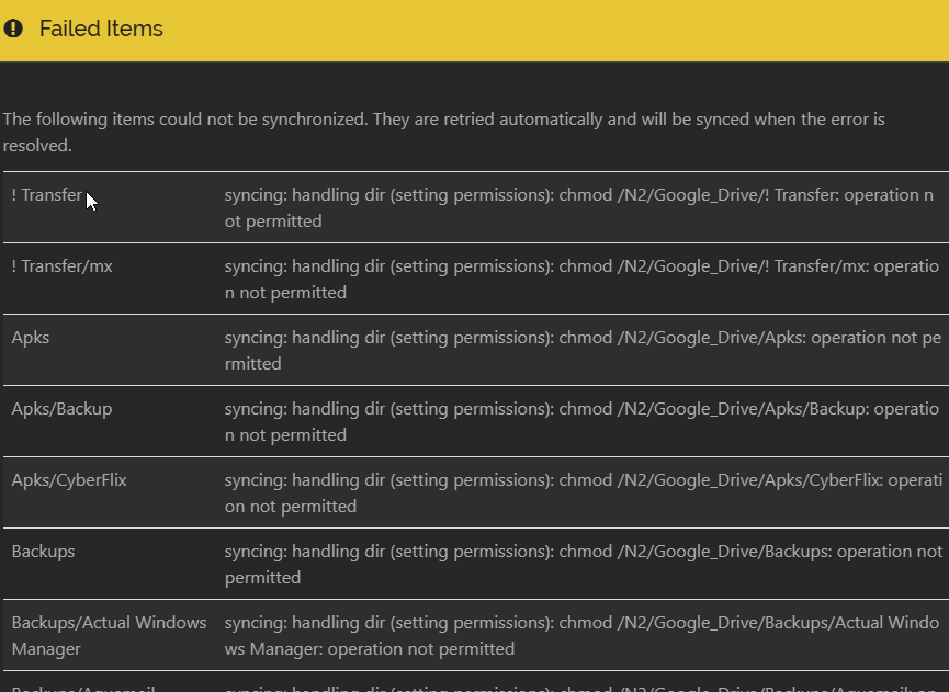

now to figure why I’m getting this, it’s like it’s mounted without -R permissions, fun lol
Out of sync as it is but at least it keeps the status past truenas reset :smiley:
sorted, had to mark that one to ignore permissions :slight_smile:
