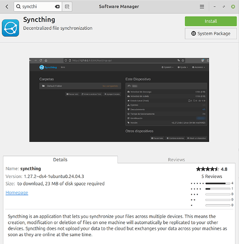

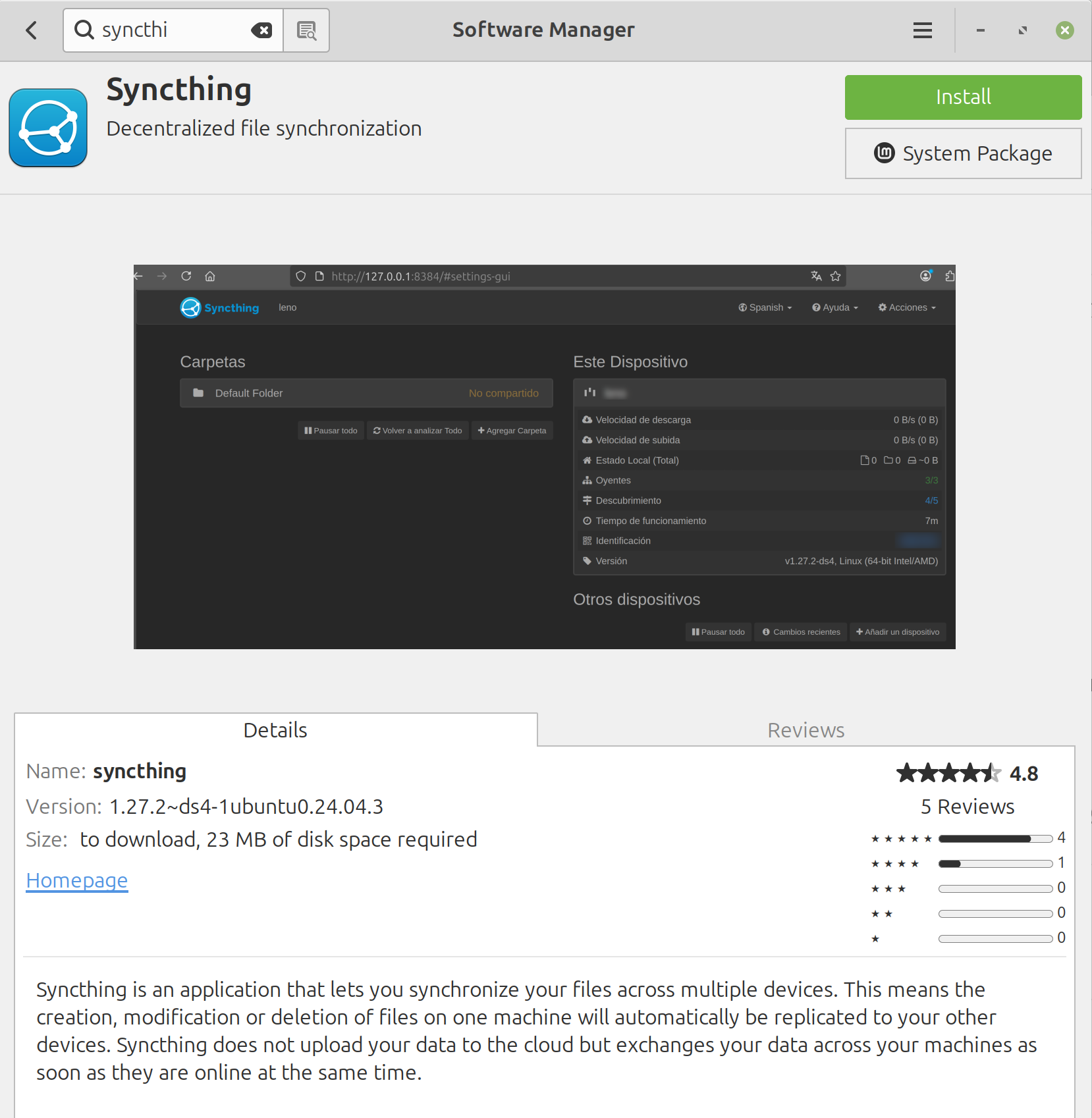

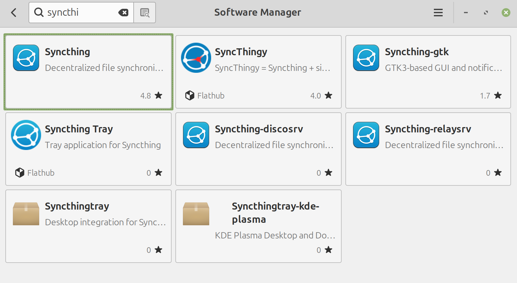

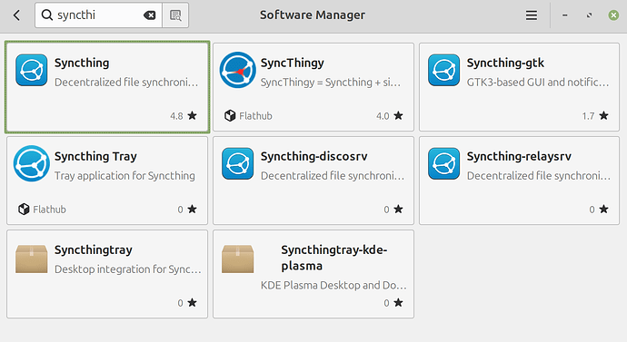

Not sure what Syncthing package is in the Linux Mint software manager. It’s not a Flatpak: they all appear in the software manager with a special icon, which isn’t on the package I’ve downloaded. This version number from my download might give a clue: 1.27.2~ds4-1ubuntu0.24.04.3 . And I think I’ve read somewhere that LM doesn’t use Snap directly. So maybe deb? (Some screenshots from linux mint software manager below).
